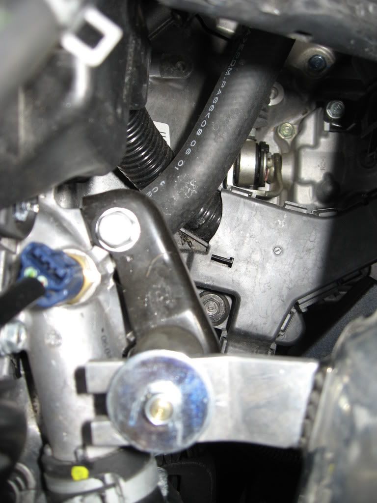

Remove the four bolts shown in the pictures below:
At this point you can lift the TB up high enough to slide the spacer behind it. It will take some work, but it can be done. Be sure to put the gasket in the grove on the TB like this (Also, you should have it sitting on there in this order; intake manifold, gasket, spacer, gasket, throttle body:
Take your new bolts (which which use a size 13mm socket and not size 12mm) and put the supplied washer on it:
I found it easiest to put the bottom left bolt on first, then the top left then the bottom right, then the bottom right. Also, I had to take a hammer and TAP on the bottom right to get it to sit in the hole right:
