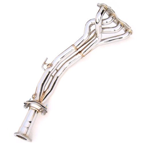

I know there are a ton of threads about our header. My question is would it be worth paying the little bit extra for the Invidia header that does not need an O2 extension, over the Skunk2 Alpha header. I have read a lot of threads bashing on the alpha header (not to mention having to extend the primary O2 sensor). And I have not really come across much negative feedback on the Invidia header. I know both have 3 inch collectors that will bolt right up to the Full Race exhaust. So as far as quality, ease of install, power, and sound go; what would you guys prefer?
Skunk2
Invidia
My car is a 2009 FA5
Thanks
Sent from my iPhone using Tapatalk

The thing that gets me is that there is a $100 difference. If i order the extension from honda its not the cheapest. If i went and bought the wires and got a soldering gun that would cost even more with the risk of it falling apart. And then there is build quality. People all over the forum saying the alpha cracks and sounds bad. I think Im just going to go with invidia.

Invidia header > alpha in quality. Invidia would be much more comparable to the s2 Megapower here.
Invidia header > alpha in fitment. I own the invidia and had 0 issues installing, no o2 extension needed
invidia header < alpha in power ( not by very much )
Sound ? Not sure here, I think the alpha will sound a bit deeper? Regardless, Invidia sounds great w/ any decent catback which is the piece that determines most of your exhaust sound output.
IMO you get what you pay for. A lot of people have had great results with the alpha. I just wanted to make sure I had no problems so I bought the invidia. If you really want the best option though I would go with a Megapower. Its only about 150 more than the invidia.
