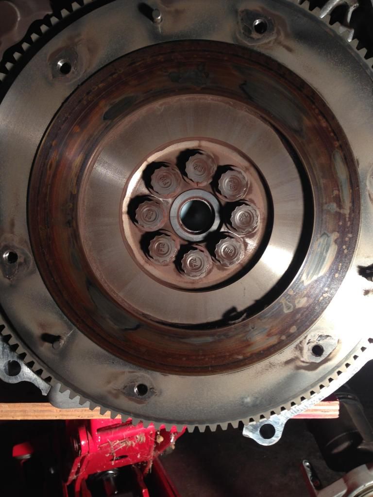

So I am in process of replacing my clutch right now.
Transmission is out and old clutch is removed.
I was hoping the flywheel wasn't' too bad, but there is a fair amount of heat marks, etc. (Pictures below)
My question do you think I should
A: Just put the new clutch on
B: Have this one resurfaced
C: Just buy a new one?
Im hesitant to just put in the new clutch on a flywheel that looks like this.
#2 ·
you should always have flywheel resurfaced/replaced when the clutch is out.
The picture shows where you have glazing. Depending on the shop costs, it can be cheaper to go new than resurfacing. Always get new flywheel bolts as well.
IMO get it done right now that way you have a long time before you have to separate the trans and engine again
#5 ·
I've seen better and I've seen worse when it comes to flywheels. That one looks like it's seen a decent amount of slipping and heat, but from the pics doesn't look like it's got a bunch of scoring from disc rivets or too much uneven wear. I'd say you probably caught it in time for a resurface to be acceptable.
For comparison, I replaced the clutches in both my cars last fall. The '92 Miata with 135k had an oil leak that took out the clutch, and the rivets chewed up the flywheel surface. Lots of scoring and chatter marks, that one I had to replace. My '06 Si had 100k on it, the flywheel looked the same as the back of the pressure plate pictured, and I got away with just scuffing and reinstalling it. Yours is somewhere in between.
#6 ·
Good choice with the resurface... the heat focused onto those hotspots actually hardens the metal and the surface wears unevenly... so reassembling without removing them will give you issues in the future.
