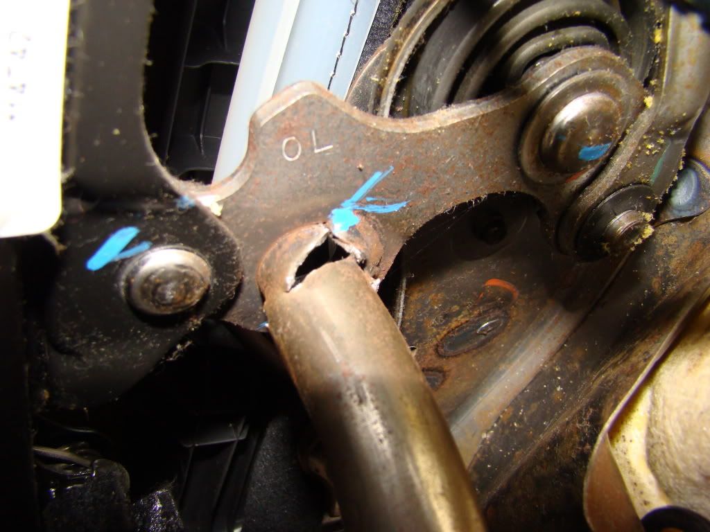

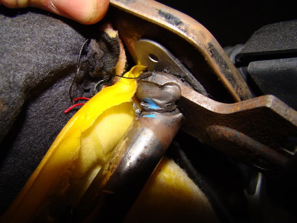

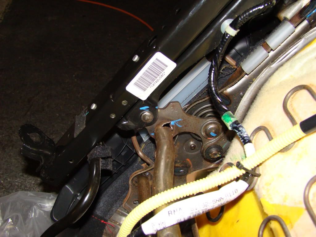

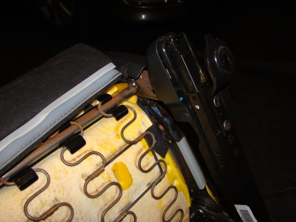

I bought my 07 FA5 exactly 1 year ago and noticed over the summer that my seat rocked right and left if i shook it standing outside of the car... today i finally took out the seat and this is what i found....
the right end of the rear bar and the left end of the front bar are completely broken on the welds, now this had to been broken since i bought the car since i am a skinny bastard. but what the heck is this crap honda?? this shouldn't break...
My question is do you think honda will cover this since its somewhat of a safety feature? my car has 71k so im out off all the regular warranties :cornmad:
Front left end bar..
Rear right end bar...

I believe that it's up to the Honda you take it to (whether they want to go through the hassle or not). They would have to check with the DSM( District Service Manager) to get an approval to be paid by warranty. This is in a sense a safety issue though. Shouldn't be under wear and tear because that can be potentially very dangerous.
#18 ·
Oh on second read through that looks like the previous owner was in an accident and didn't get a proper repair.
In that case I would get that fixed (part replaced) and get your entire vehicle checked out.
You could very well be driving a death trap. If it was a bad enough accident to break a seat it could have very well broken some other things. I would't trust a weld to fix that.

My concern would not be the seat alone, it would be the rest of the car. Obviously the
shop that "fixed" this seat didn't do a good job. Which indicates they may have done a
bad job repairing the accident damage for the entire car. Bad things can happen when a
car has been repaired incorrectly.
Please take it to a pro or the dealer and have the car looked through.

Car was never in a wreck, the previous owner took very good care of it ( he was a fat guy so i assume he just jumped in the seat a lil too hard..) , I called honda and they said they couldn't do anything for me, a new seat rack is $900... so im taking it to a professional welder today to get it done right, thanks for all the input guys ill post of pictures after i get it welded
