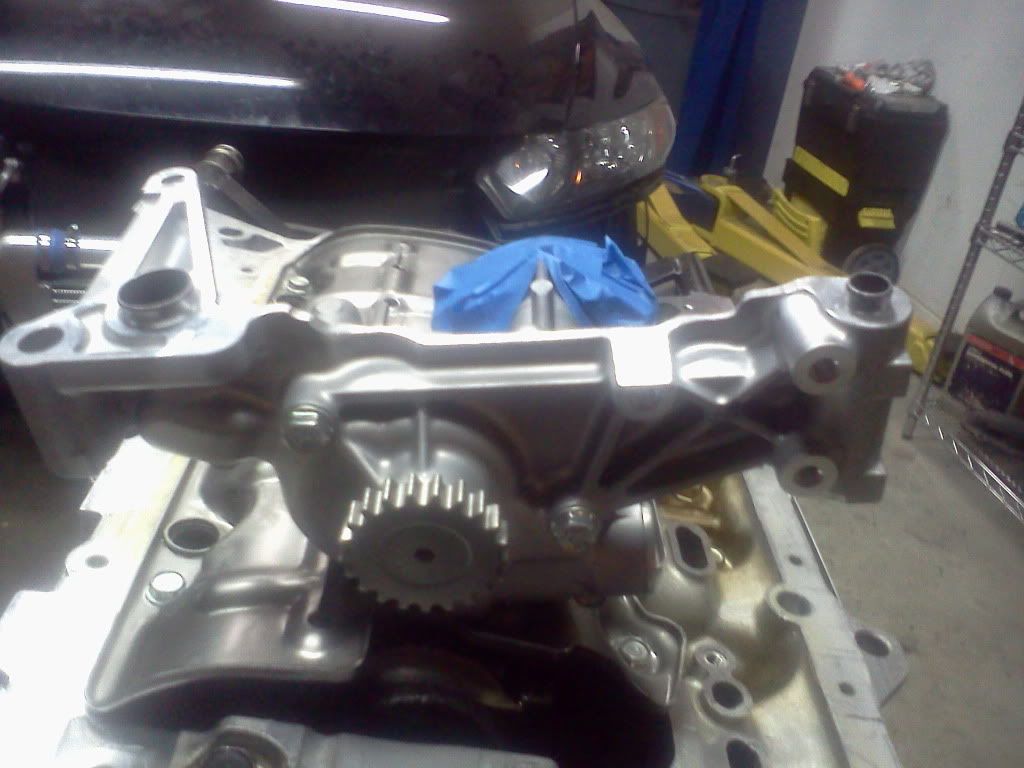

side by side view of the new RSX oil pump modified to the Z3 pump with balance shafts

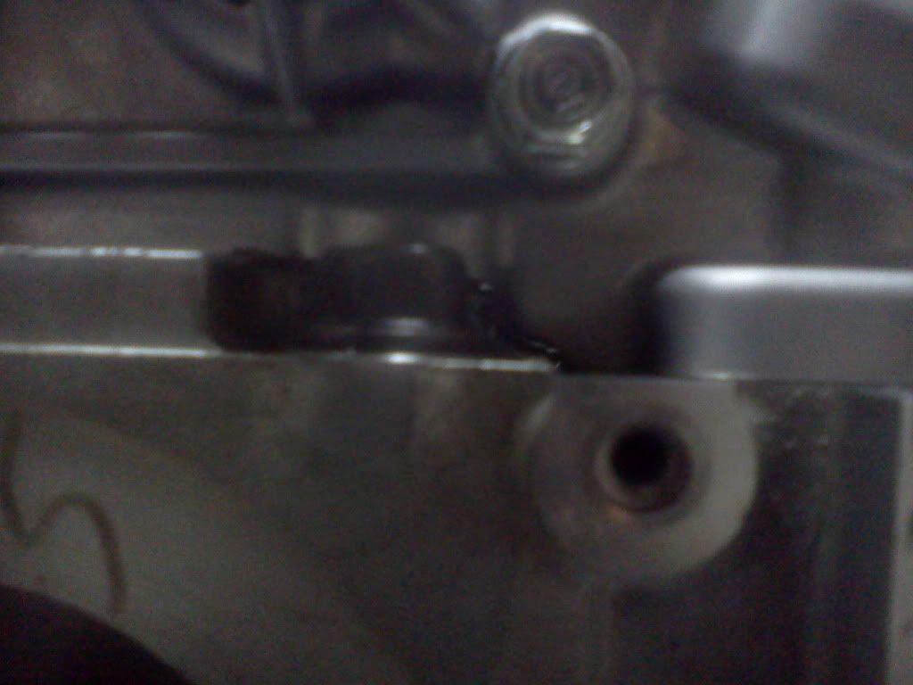

here is a close up of the grinding u must do for this pump to fit the Z3 block

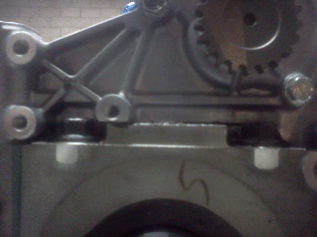

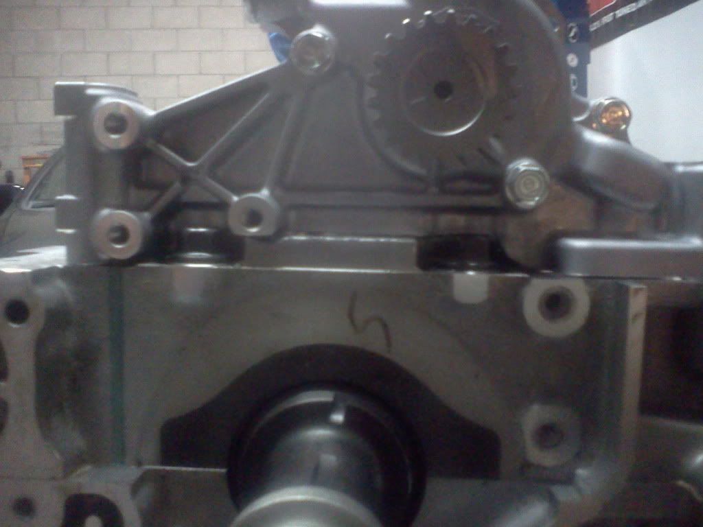

on the motor.

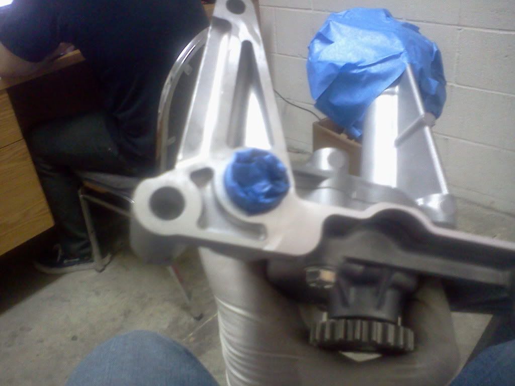

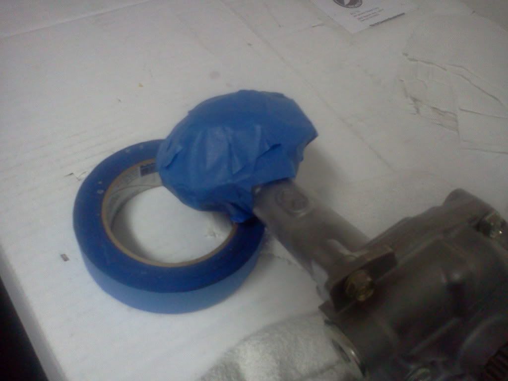

tape off the pumps mouth and feed hole with painters tape.

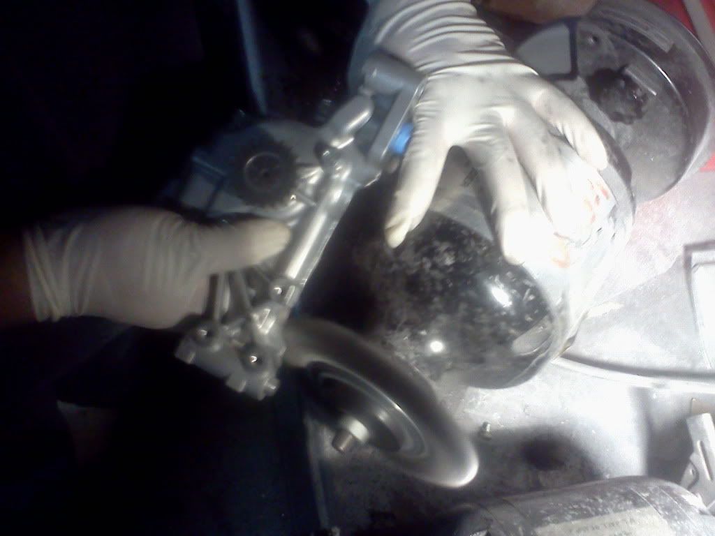

grind off the area with a bench grinder and smooth out the rough edges with the wire wheel.

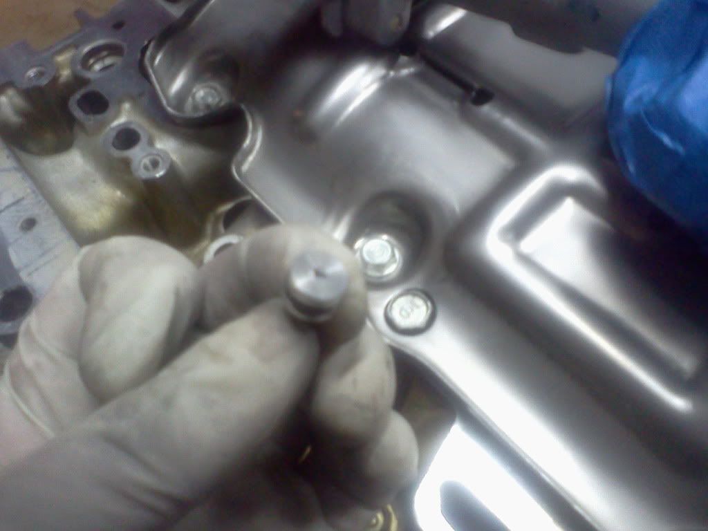

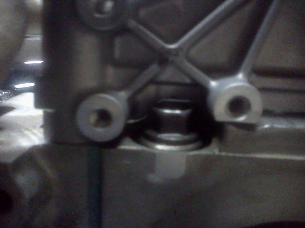

IMPORTANT!!! do not forget to remove the oil feed orifice and replace with 12mm bolt as mentioned on the parts list.
on the motor.
