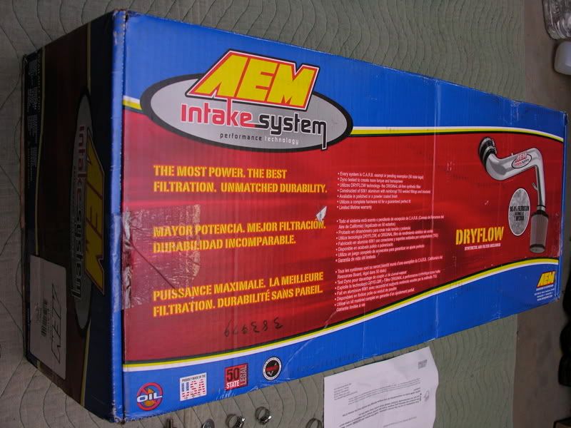

AEM-$268
AEM - Cold Air Intakes

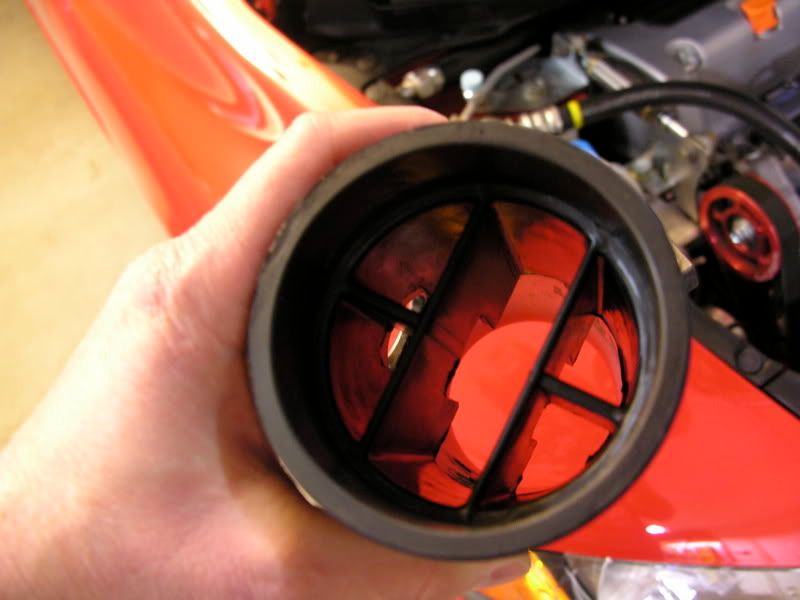

AEM CAI #21-519C (Version with "Flow Straightener/Coupler to fix MAF issues)
Great thread by OrdnanceMarine: http://www.8thcivic.com/forums/bolt...flow-straightener-coupler-fix-maf-issues.html
AEM-Price about $260 Uses dry filter and seems to have tried to address the vanes in the MAF housing.
AEM - V2 Intakes
http://www.8thcivic.com/forums/bolt-ons-all-motor/96430-new-aem-design.html

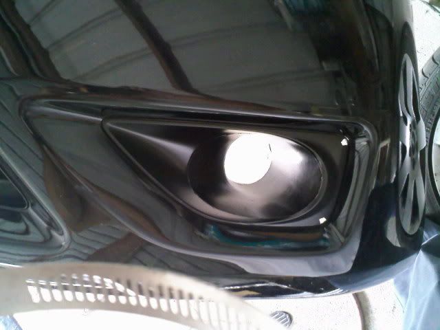

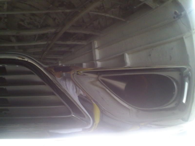

8. GeezerSi DIY on Fog light opening to get colder air to intake on CAI or M&M:
http://www.8thcivic.com/forums/engine/50418-diy-fog-light-opening-vent-conversion.html

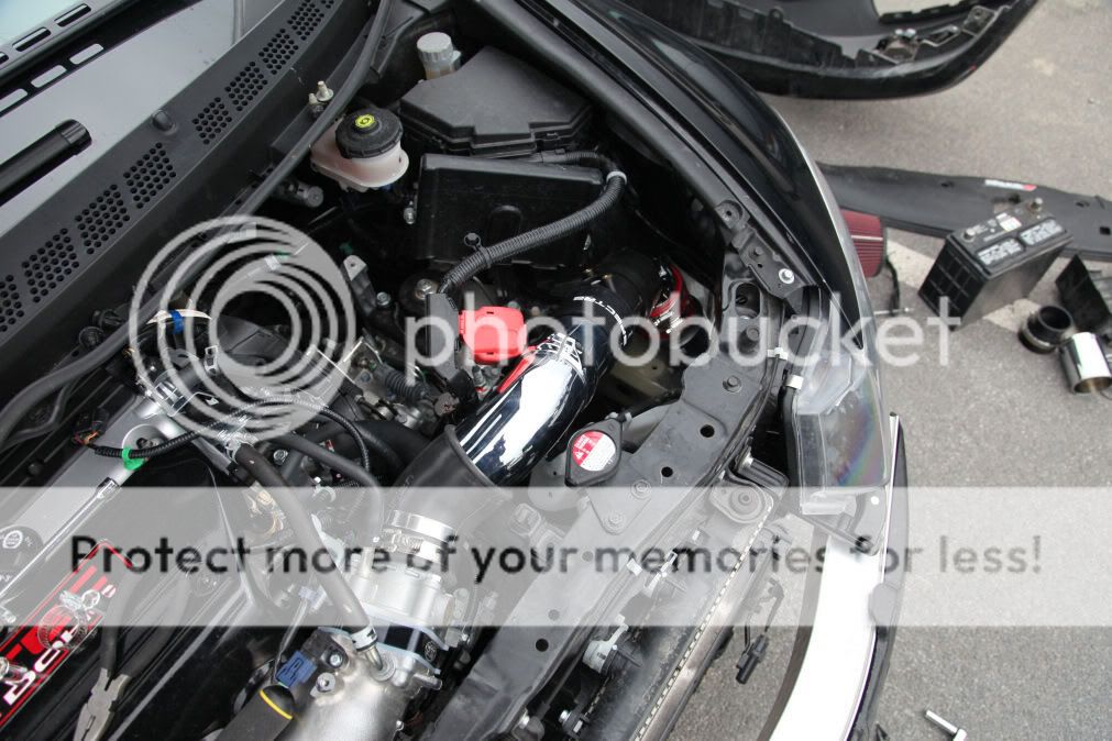

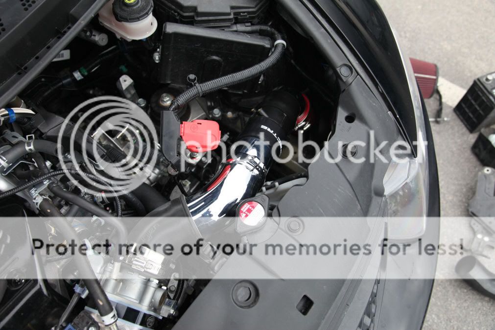

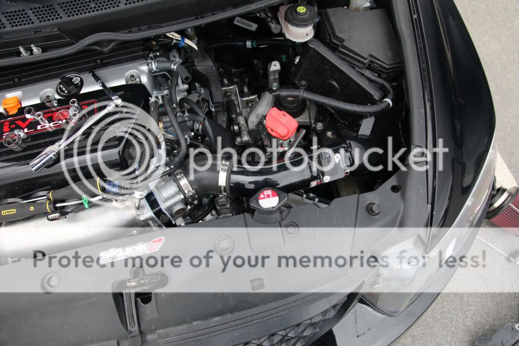

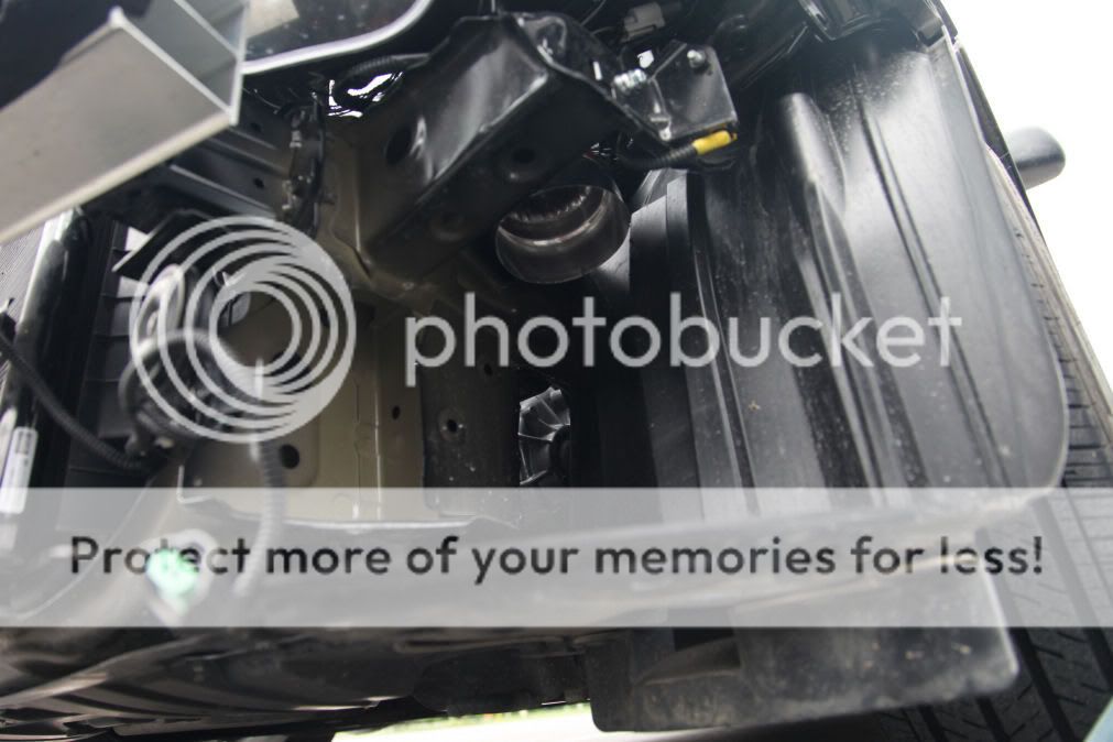

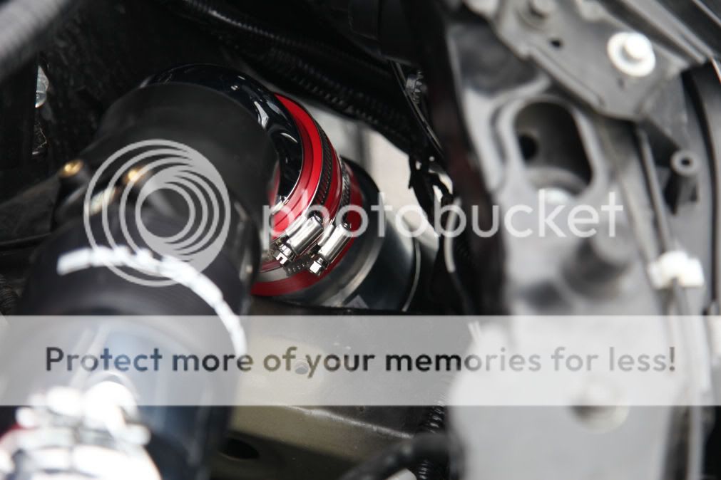

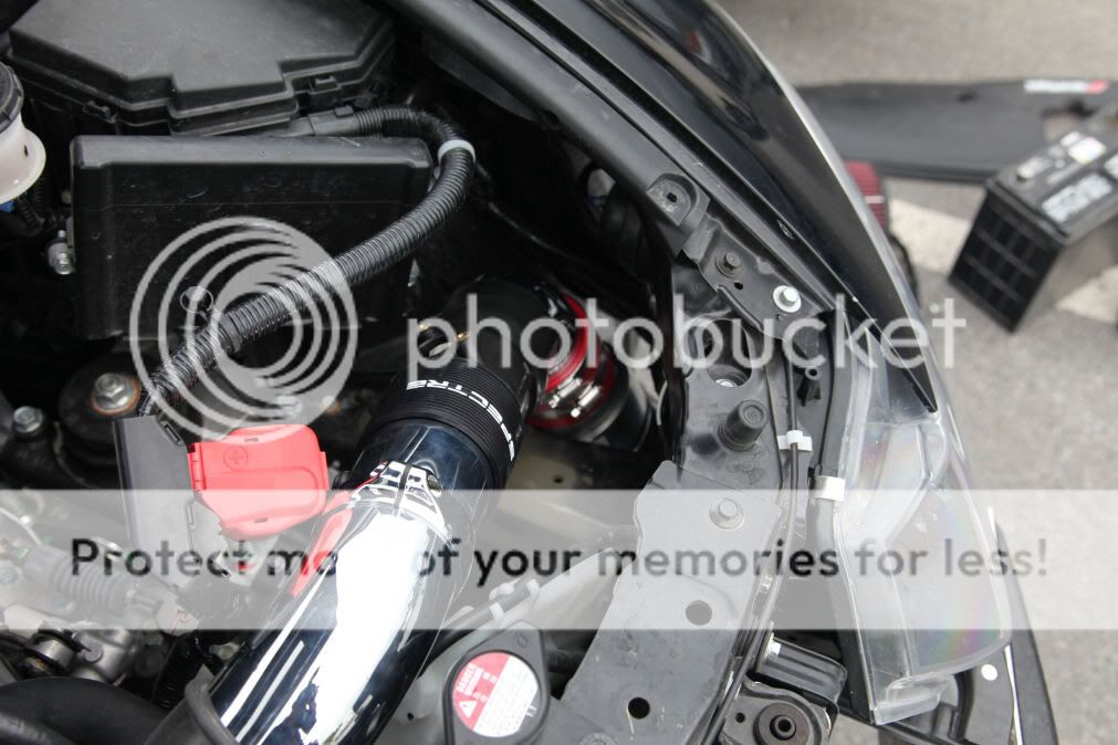

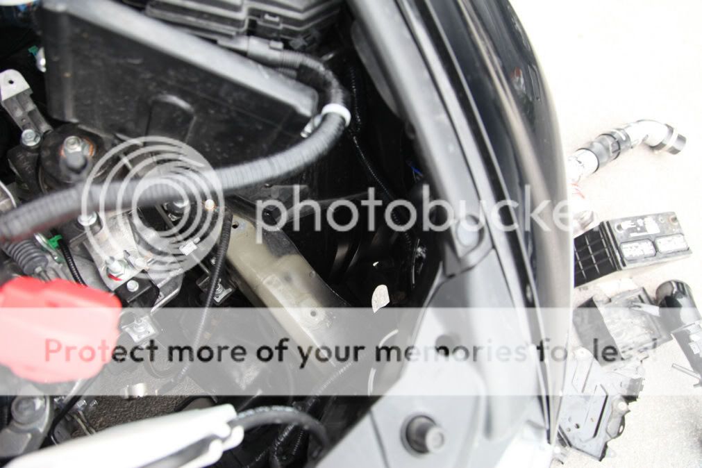

12. Thread by redviking about innovative intake where battery is relocated and filter is placed near factory cold air inlet. http://www.8thcivic.com/forums/bolt-ons-all-motor/107055-new-sri-set-up-repost.html#post3285609
Original blog: My 2006 Honda Civic Si JDM FD2 Blog - On Demand | Jack's Honda Civic FD2
Remove OEM intake and battery:
Relocate the battery with a custom tray, were the OEM intake filter is.
Final product:

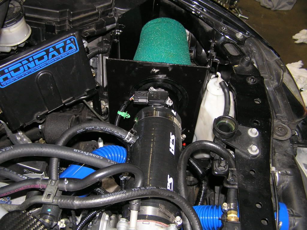

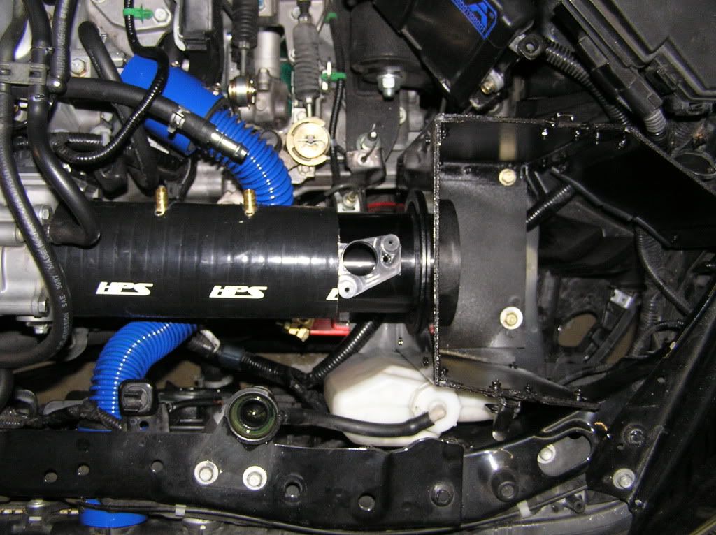

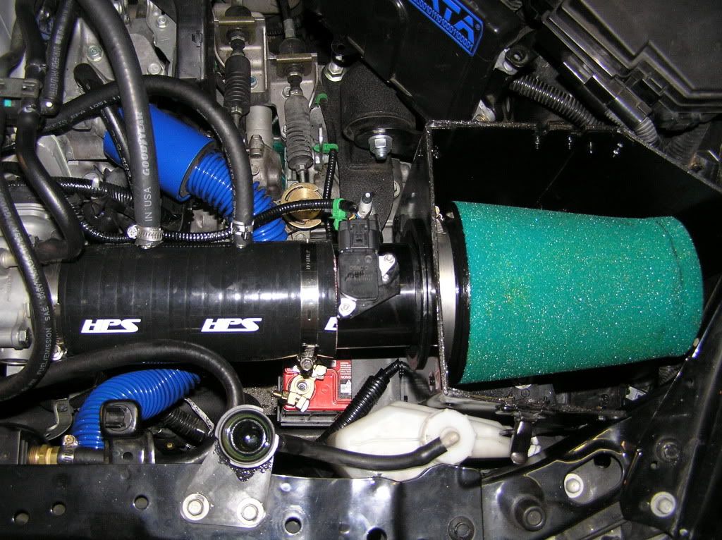

12. 200HP EP and his homemade T1R airbox with Amsoil cone filter and soon to be added M&M scoop"
http://www.8thcivic.com/forums/bolt...-my-t1r-air-conduct-box-version-x-intake.html
So I decide to made it because of heat soak problem.
I used:
-original X intake
-CRV tube
-amsoil filter (same as NitrousG35)
-SI intake box with the cover rebuilt by me
-OEM gasket to perfectly seal cover and base together. I cut the little lip all around the OEM filter and used it with the gasket.
Now I'm waiting for the M&M scoop... and this is my temporary version :laughing:

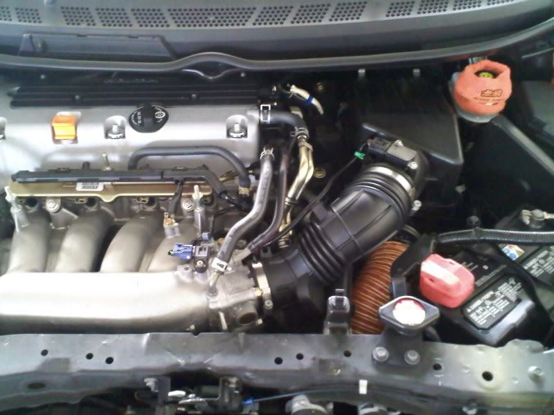

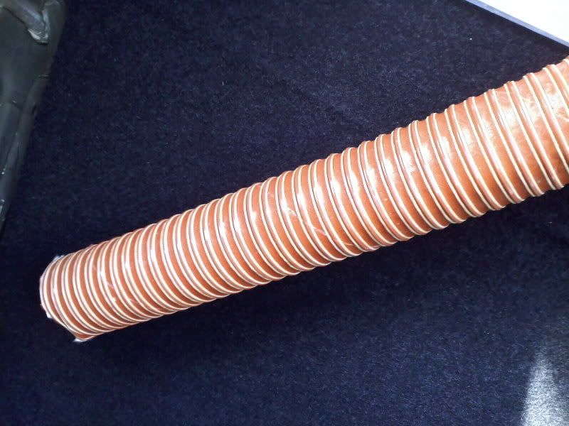

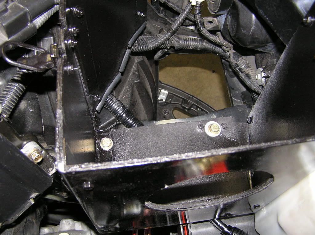

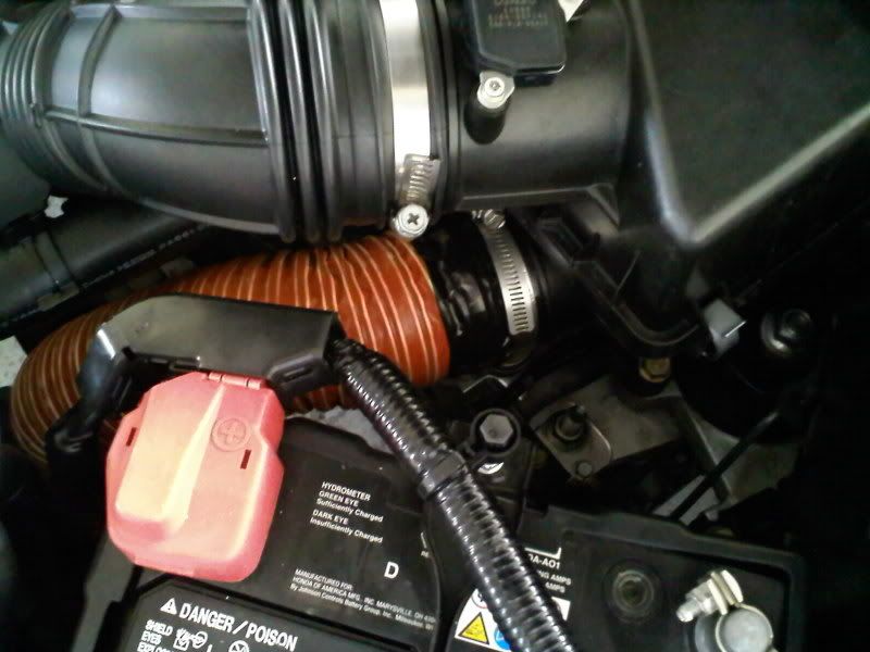

13. Kenua6 and his ducting from the lower bumper to the base of the airbox, ushering in cooler air to the intake: http://www.8thcivic.com/forums/do-y...made-ice-box-led-plate-light.html#post2914719
Just did some little thing over the weekend, I already did the KN drop removed resonator and 6k HID few week ago, but I think the that intake sucking the hot air is not good so I go ahead and did custom piping for the intake, and also I moved the rear spoiler move rear cause I dont like the rear spoiler when I first got the Si but now I love the spoiler alot more.
finish all the typing please enjoy the picture guy!!:dance:
home made ice box
Some pepboy ram air kit and 135 degree silicone hose I sell size 2.75"

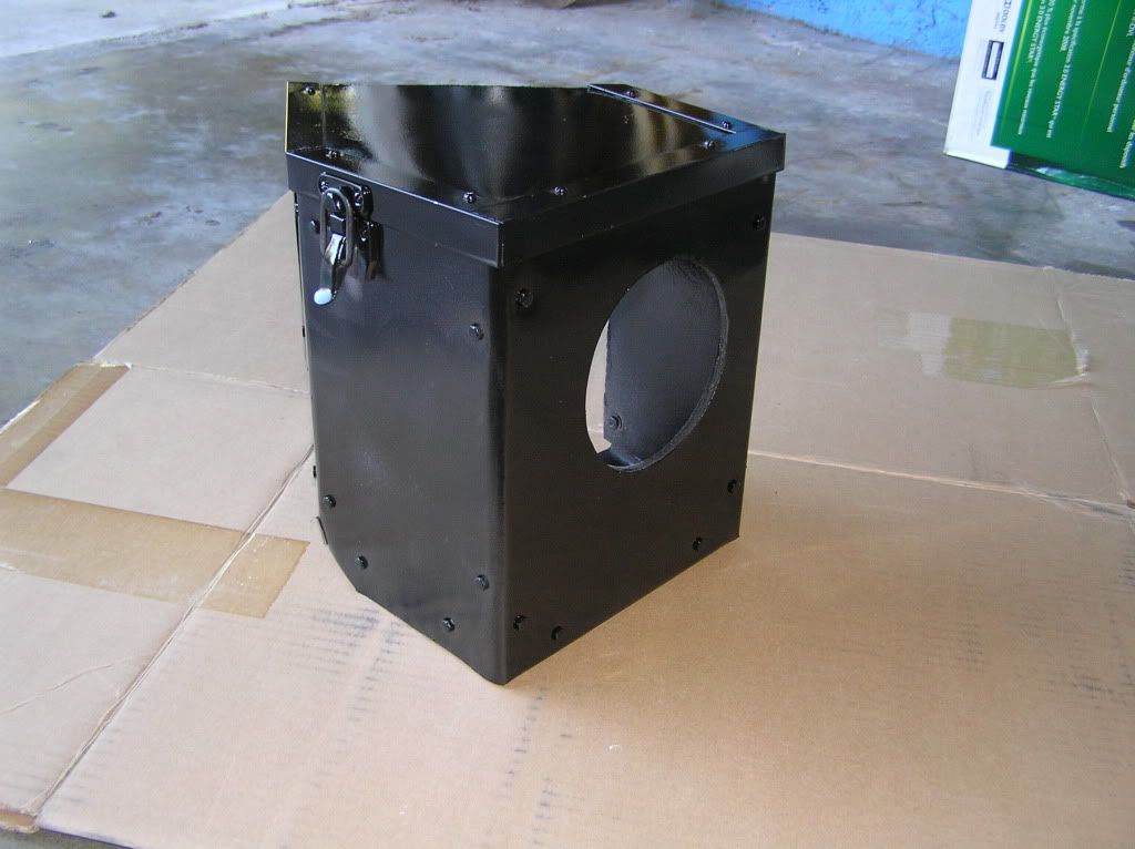

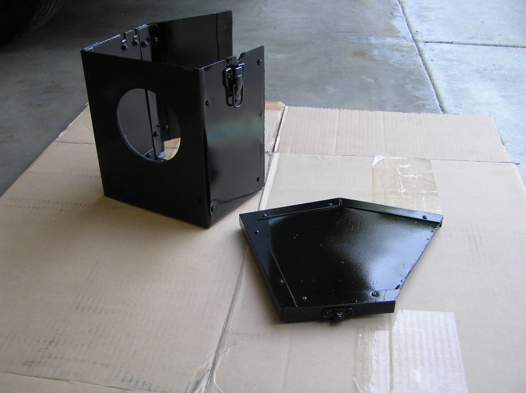

Civic93 and his beautifully constructed airbox cover, T1R type scoop, mock ups, prototype and molds. Definitely the most sophisticated system to date for the DIY'ers:
Here are some updates on my intake that I am making. Let me know what you think. As of now both molds are done. Going to sand and wax them and make some final products soon. http://www.8thcivic.com/forums/bolt...ates-my-t1r-mugen-style-intake-lots-pics.html

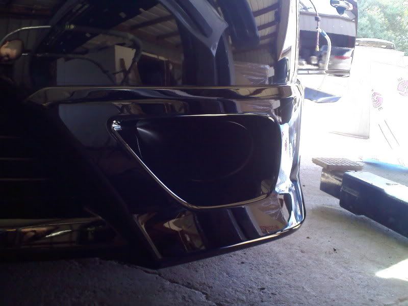

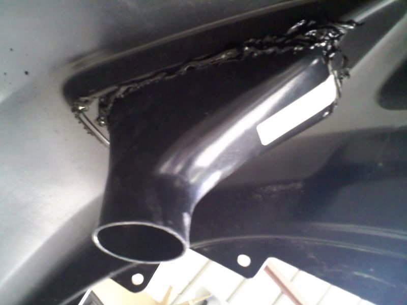

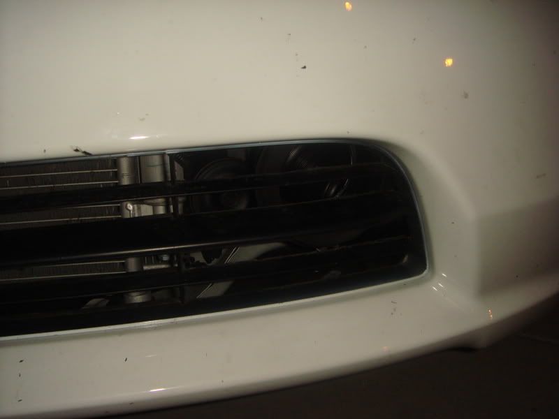

Company called, "Backyard Special". Made scoop similar to M&M:
Blog Archive FD2 Intake Air Ducts
Initial observation of the product was that it was of a lesser quality compared to the M&M, which had a nice FRP gel coated finish. In fact, the piece i had where the 2 separate fibreglass pieces butts were met, besides having the normal faint line, it had a crack! But I guess, functionality wise, it will work just as well (regardless of fibreglass finish).
This air duct gets the cool air from the large front air dam and gets routed towards the airbox in a more direct path. It also has a larger catchment surface area and should be more efficient.
Here are some pictures of the installed product:

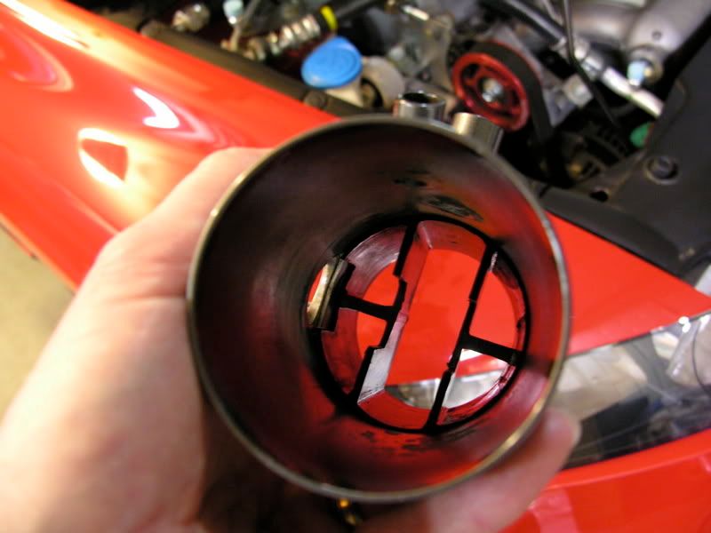

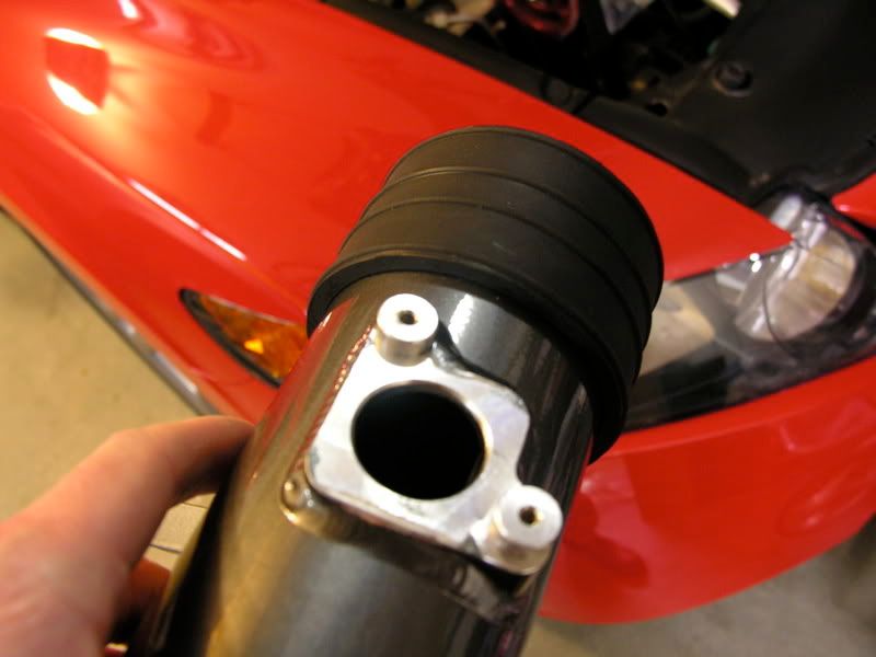

I chose to retain the stock intake tube rather than using a CR-V one, and removed the stock airbox. I cut out the MAF housing from a new OEM airbox lid ala the X-intake, and modified the vanes in standard X-intake fashion.
I made an aluminum insert for the boss on the side of the MAF tube that orignally mounted the clip for the MAF wire. This insert has a hole drilled into its side which is tapped for 1/4"-28. The side mount bolts to this.

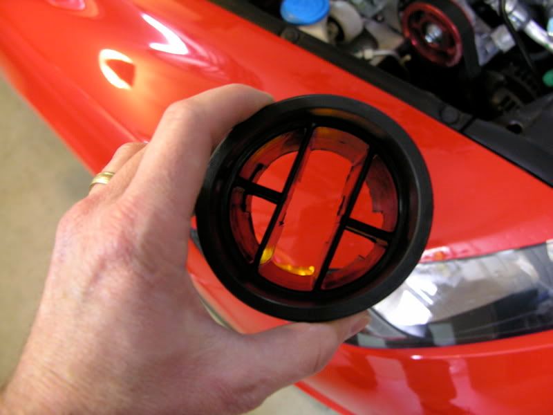

To tune the intake a 3" tube is placed after the MAF housing, before the air filter. Considerable testing has shown a ~4" length to be optimal for my car, but this is very critical. 1/8" of an inch either way is a big change, and getting the tuning just right is what makes the intake worthwhile.
Note that the bellows construction of the OEM intake tube section allows it to be compressed or stretched some distance. Exactly how long you have the tube extended or compressed by your mounts will affect your tuning and influence the optimal extension length. For these reasons it is recommended you try different extensions lengths to experimentally arrive at the opiimal length and insure the best results. This is easily accomplished with tube spacers, which we will get to in minute.

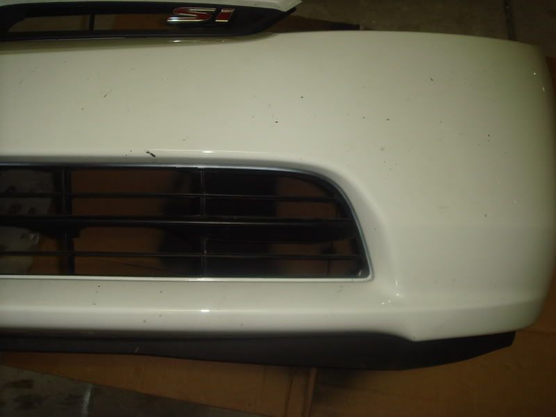

x fg x Custom ram air intake v3.0[/B]
So I got some bumper damage to to the front of my car so naturally, I decided to have some fun and modify my car while it was getting fixed. So I guess the short hand version of what i did was, I ran a tube from my factory intake box, to my fog area, cut a hole out of the fog light cover, and connected the tube to the hole to get a direct flow of air from outside of my car, to the intake box.

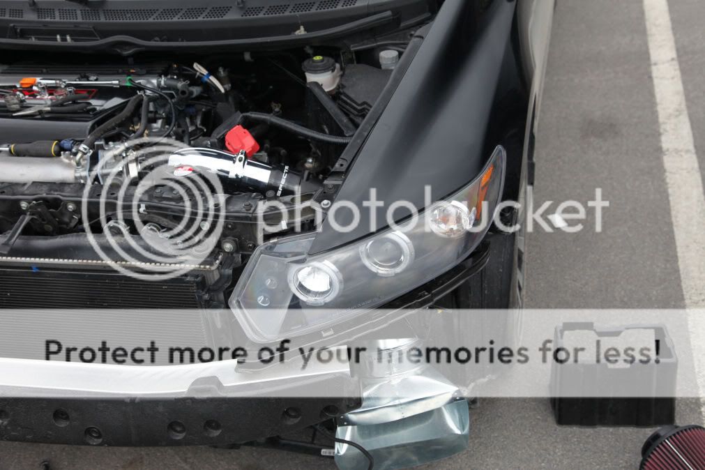

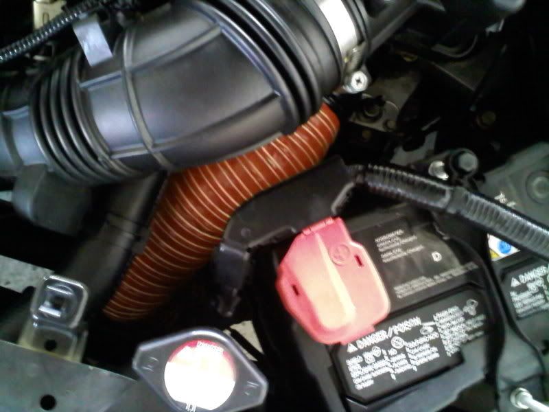

The idea here is, is the air that hits the front of my car, will enter the intake piping directly, and then cause a "Ram Air" effect in the intake. Does it work? I will never know untill I dyno it with a powerful fan placed right in front of the intake to simulate me driving at speed.
So heres how I did it. I purchased a brake duct and some silicone brake ducting tubing. I cut the hole out of the fog light cover, and I also cut the fixtures on the back of it to allow for the brake duct to be placed directly behind the fog light cover. I cut the brake duct to size and I cut it so it fit fairly close to the bumper. And I 40/40 glue'd it on, making sure it had a complete seal. So now what I got is a hole in my front bumper, with a duct behind it that reduces down to a 3" hose fixture. This is where I clamped the silcone brake duct tubing. The tubing is nice and smooth on the inside, its non kinking, and its heat resistant up to 550 degrees. I ran the tubing to my airbox and I attatched it there. As for the air box itself. I took it out, and I smoothed out the inside and I put in a K&N air filter to allow the air to flow more free inside the box.
So with that, I now have a conceptual Ram Air Intake. Like I said before, I do not know if this really works, But its just a theory and an idea I had. But I posted it because I had a fun time making it and quite frankly, I think it looks pretty clean. I still have 1 more thing to do to it, and that is installing a mexh like filter in the ducting to prevent things like cigarette butts and what not from flying into the intake.
Here are the parts that I ordered from Pegasus Auto:
And here are pics of it installed:
Intake from unknown source:
Bignewegg http://www.8thcivic.com/forums/bolt-ons-all-motor/162643-custom-ram-air-6-intake.html
Hey this is not my final product but I just couldn't wait to try it out. I went out to the car and test fitted all my parts and so far so good. Here are a couple pics. Also if anyone has any input or ways to improve the design it would be appreciated. I got some help from NitrousG35 from where to get the MAF housing. I ended up using the stock box and cutting it out. it was exactly what I needed.
I will need to remove the battery and relocate it for my setup to work. I've seen some other people do this with a CAI but i don't think I've seen anybody go my route with a ram air from the fog with a scoop my size.
there is so much room there without the bracket i could probably run larger tubing!
I used my Injen SRI as a test tube at first and it almost worked out but the end of the tube is some weird size and I couldnt find tubing to connect it.
Thats where the custom tubing comes into play with the MAF housing sitting in between.
Here is my complete setup. Yes that is a 10" scoop leading to a 6" tube that tapers down to a 4" then a 3" !!
I test fitted it all and started the car up. Sounded fairly similar to the SRI I have in there but I'm sure at speed it would be even better and at WOT.
I will have a video of the part where I have the car on in a couple hours.
I will gladly take any criticism and comments. I would like to know what ya'll think and how if anyway i could make it better. O the scoop will sit right behind the driver side fog light and yes I will remove the foglight and run a screen and filter in that spot.
Mike_Si_29 CT intake with custom airbox: http://www.8thcivic.com/forums/bolt...t-intake-custom-heatshield-small-battery.html
Hi guys,
I decided to build heatshield for my CT intake. I got small battery, relocator kit, 3" HPS silicon tube, sheet of aluminum, mold insulation (good up to 1300F), and some screws. I also have NACA scoop in front of radiator like many of you do. Air is guided underneath the filter. Still didnt get a chance to compare intake temp. to the outside air. Also, I will probably data log my AFR later on to make sure its in a right range.
I thought about making cowl induction, as i did earlier, but i think it will restrict some of the air for CTSC 2. I would have to make a pretty big hole in a cowl. Plus i already made one, so i decided to try something different. I dont know if i gained any hp or not; my main goal was decrease intake air temperature. I will give you more updates later on after I drive for a while. RPMs at idle are stable, but we will see. Anyway, here is what it looks like. It still needs a few minor touch-ups here and there which I an gonna do later on. Comments/suggestions are always welcome. Thanks for viewing...:wavey:
HPS Silicone Intake tube
From Samer327: http://www.8thcivic.com/forums/intake-spacer-discussion/148623-hps-silicon-intake-hose.html
HPS is now making silicon intake hoses to replace the existing OEM intake tube. The tube is made from high temp, multi-ply silicon intake hosing, which should improve airflow and keep air inlet temperatures cooler. We will be dyno testing later and measuring air intake temps as well.
Differences I noticed
Throttle response seems better
RPM down low doesn't bog as much
Smoother powerband from idle to redline
Looking to get on the dyno after Long Beach Grand Prix.
Here it is
Here it is installed
