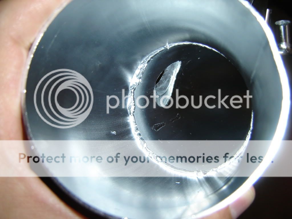

Just received my intake a couple days ago and I am seeing something that is bothering me and want to get some input from others with aftermarket intakes. I noticed the welds (on the inside) are very lumpy/clumpy. I emailed takeda about it and the engineering dept said I should not have an issue with it. I am worried about extra turbulence in the pipe due to the irregularities. Does anyone else have a sri that has similar welds on the inside?

The welds will not cause a noticeable flow disruption, but usually welds like that are indicative of a poor welding job.

^^I was thinking that. I have a rotary tool but I am worried if I take off the finish that it will cause the intake to oxidize?

That looks like something I welded together! Actually, those look better.
I'd demand my money back. That looks like crap.
8,756 Posts
That's not a defect, it's just not a very good weld.

Yeah, after I showed takeda the pic they said they were going to talk to quality control about that. I am just kinda up in the air as to what I want to do. I dont know if I want to just sell this and buy a aem cai and be done with it or just keep this and deal with knowing I have poo poo welds. I am going to loose my ass if I sell this because I am not going to try to sell this for what I paid for because I do not think its worth it because of that weld-job.
