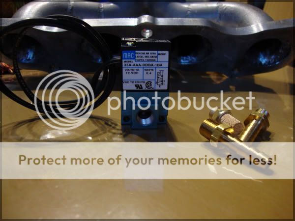

I just received my solenoid in the mail a few hours ago. It arrived in just 3 days! I immediately opened it up (in excitement, of course :woowoo: :dancing: ) and this is what the packing revealed:

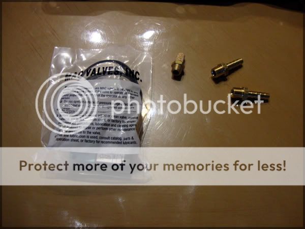

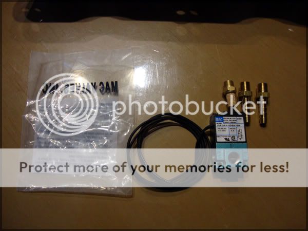

I opened up the package, everything seemed to have been neatly placed into the MAC solenoid box, which contained the MAC solenoid, 2 fittings, and the filter.

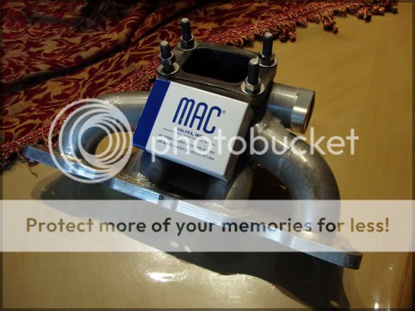

I was very pleased with how properly everything was done. I have yet to install my turbo kit, however Supa Ninja (Nick) did full testing of this solenoid on his own car with his own solenoid initially before sending anything out. I'm sure when everything is installed, it will work exactly as it should. Rarely do other members on a forum go out of their way to help others, and Nick did just that. I just wanted to give him a little write up to thank him, although he had no idea this was coming :lildevil: $50 shipped definitely beats the $100+ Hondata Boost Solenoid, and it's EXACTLY the same thing! Well, without the $50 Hondata sticker, of course. :wigglesmiley:
P.S.- The manifold does not come with the awesome Supa Ninja solenoid :giggle:
