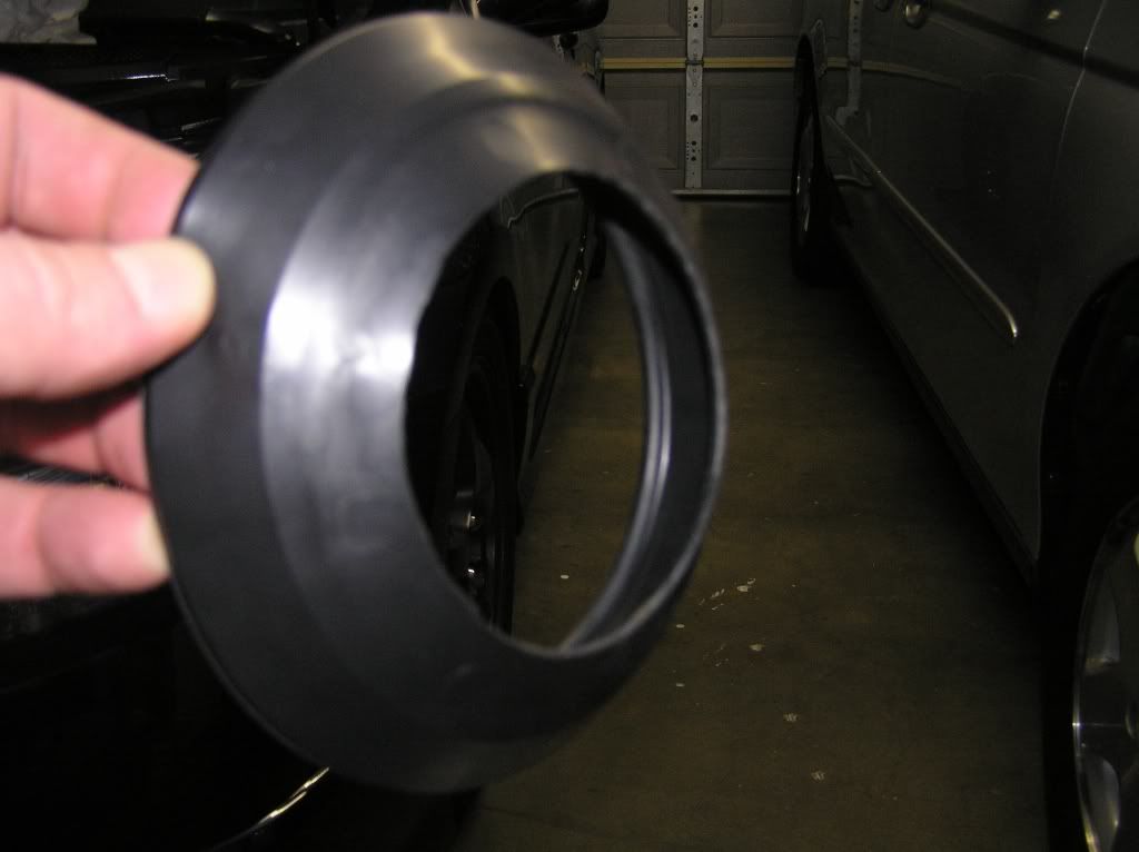

As you can see, there is a large spacing around the heatshield inlet now. I know, maybe there is really not much heat will come through there, but i still wanted to make something to reduce it a little. I went to Homedepot and bought one of this things. I really dont know what it is but its in a HVAC/ plumbing department. Cost about 5-6$
The rest is pretty simple and self-explanatory.
After that, hose lays down in its natural position and doesnt experience any pressure that causes bending. Here is how it all looks together
i know, its nothing big, but i thinks its a cheap way to somewhat effectively block the heat. Hope this info will help other members who are looking to use the same parts. Thanks guys
