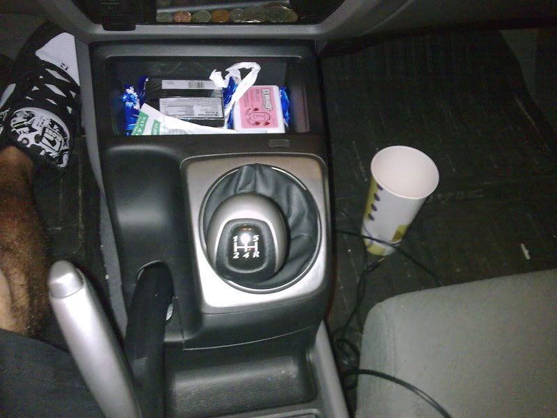

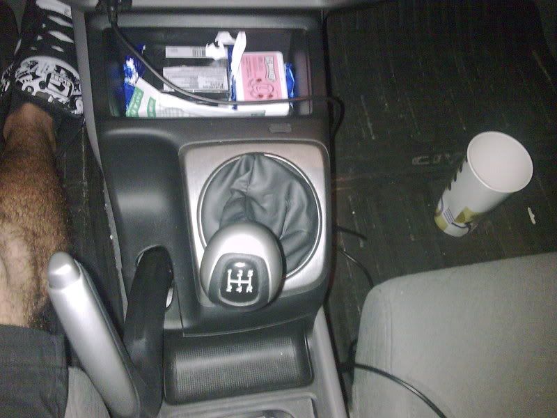

Hey guys I just wanted to let everyone know that the Skunk2 short shifter works perfectly with the non-si models :dancingcoolsmiley: :woowoo:. I just installed it on my LX and let me say that it was well worth it. The shifts are much shorter and much more precise than stock. The install was easy too, it took about 30 minutes just because the blue cap was a PITA to take off (hint:use 13mm wrench to pry it off and to get it on the skunk2 piece just rest it on top of it and gently step on it :thumb:). I'm very happy with it though and would highly recommend it. Now I can't wait for my Skunk2 shift knob to come in :dance: Oh yeah and mad props to ek24monster and King Motorsports Unlimited, Inc. for letting me be the guinea pig!!!
Here's a before and after of second gear to show how much shorter the throw is.
Before:
After:

Is it just me .. or is there no difference in the before / after shots lol ? I also have the Skunk2 on my Lx, I love it ! dang cold in the winter though.

and there is a huge difference in the throw if you look at the shift knob in the before pic its almost over the coin tray in the after pic it's not even over the silver trim. :thumb:
