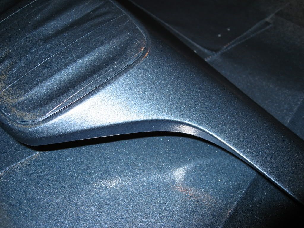

2) A close of of some of the flaws that remained after sanding. If you bought a new one, you don't have to worry about this.
