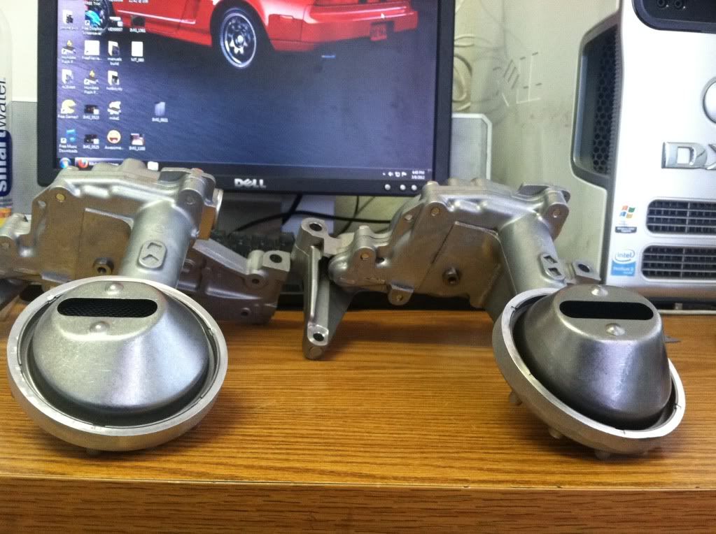

look these pictures...RRC and RSX-S pump

you are sure? When I look at my pictures....drive wheel, both have the same number of teeth.
So I think the RSX-S and RRC are the same inner life??
I know the rotor inside from the RRC but not from the RSX-S :(

RRC oil pump vs PRB (RSX type S)
here is the difference side by side
3
Can you pull the pump apart and look at the actual pump gears or the pump vain's as it is actually called.
i guarantee that internally it's like the RSX one.
