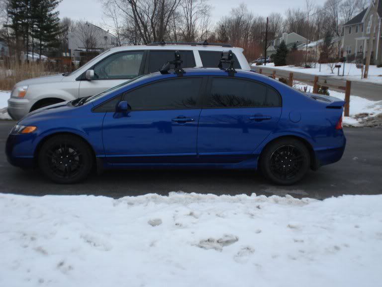

So I've started to consider myself a Roof Rack guru as of late. My car (FA5) and my brother's car (R18) are both outfitted with roof racks. We have all the attachments (ski/snowboard, Roof Box Carrier, Kayak, and Bike). As you can see the cars are outfitted for winter mode with painted stocks (R18) and painted RSX Base wheels (FA5).

To start off I'll go with the R18, and list the parts.
THULE 2172 INSTALL INSTRUCTIONS
You will NEED the following:
Thule 400 foot pack. You can use the old style which can be found on eBay for cheap (what we did) or you can get the new style feet. The new feet are called 400xt or 400xt rapid. They make a rapid load bar and a regular load bar. I personally don't see the benefit of the rapid load bars but you might. The feet are the metal brackets that support the load bars and can be seen below.
The fit kit for the coupe is #2172. These are the rubber bottoms that go on the bottom of the feet and the clamps that hold the feet to the car.
Along with the fit kit you will need the 477 short roof adapter. This allows the rear load bar to be properly spaced from the front which can only be achieved with the short roof adapter (bar parallel to the car).
Then obviously you will need the load bars LB50. These support whatever it is that you choose.
Something that is optional is the front wind fairing. This is model 872xt (large). This greatly reduces the wind noise, to the extent you don't realize that it's on your car from inside. It also adds some style and helps with the MPG by reducing the drag.
Now on to the FA5. For this you will need the same 400 style feet. New or old whatever route you decide to go.
For the FA5 you'll need fit kit 2171. Again these are the rubber bottoms and clamps.
The 4 door uses the same load bars LB50 and the same wind fairing 872xt (large).
INSTALL INSTRTUCTIONS FOR THULE 2171

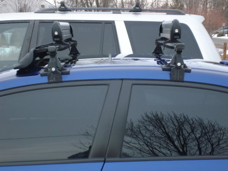

Now when installing the rack systems be sure to follow the instructions EXACTLY. You want to start with putting the feet on the load bars and spacing them apart to the exact measurements. The fronts are going to be wider than the rears and make sure these measurements are exact. They can be a little primitive and hard to follow but the basic idea is measuring exactly. Then rest the bars and feet on the car and space them from the windshield according to the specs. Make sure the distance is the same on center. Move on to the rear load bars in the same fashion.
Now when tightening the clamps you may be hesitant because one side sits further in on the roof then the other. Tighten the opposite side to draw the other side closer. You want to tighten the clamps evenly and tight enough so that the load bar is slightly bowed. When you see the bar bowed downward you are good.
Again my instructions are a basic idea but I would be more than happy to try and walk someone through the process if needed.
