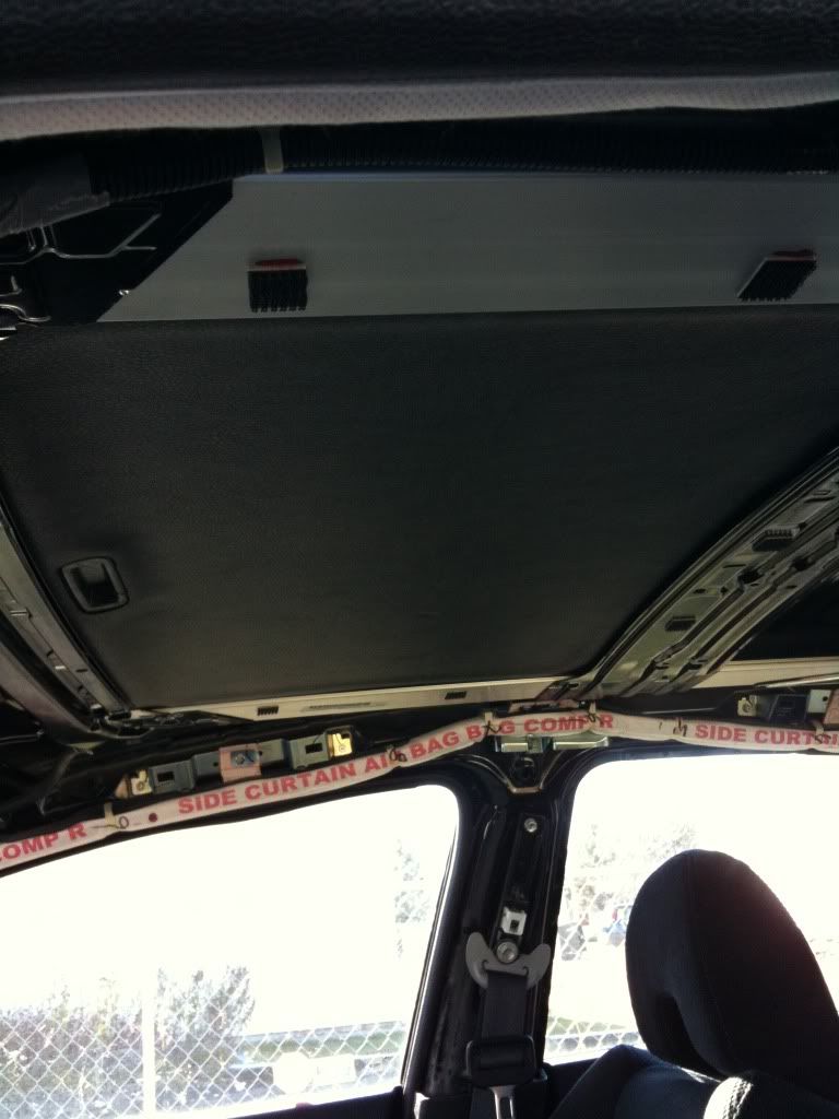

12) to take off the "holy ****" handles, pull it down then using a small screwdriver take off the covering that looks like it is holding it to the car. Then using two screw drivers pinch the metal piece together and pull the one side of the handle off. Repeat for the other side of the handle. Now take the metal pieces out. Repeat for all handles

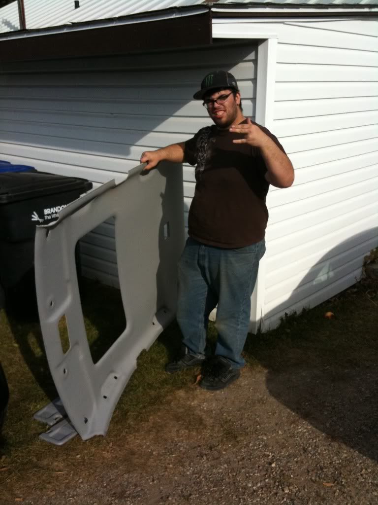

13) now to remove the actual headliner. Pull on the edges of it (from each door all at the same time) it will seem to just pop right off. It is held on by 2 plastic pins in the rear and 2 in the front. If u have a sunroof the the area around the sunroof is held on by velcro or at least mine was
14) to get the headliner out of the car was incredibly difficult to say the least. But if u have a sedan u must crease it a tiny bit (make sure u have the front seats tilted back all the way and pushed back as far as possible) and pull/push it out the front passenger door

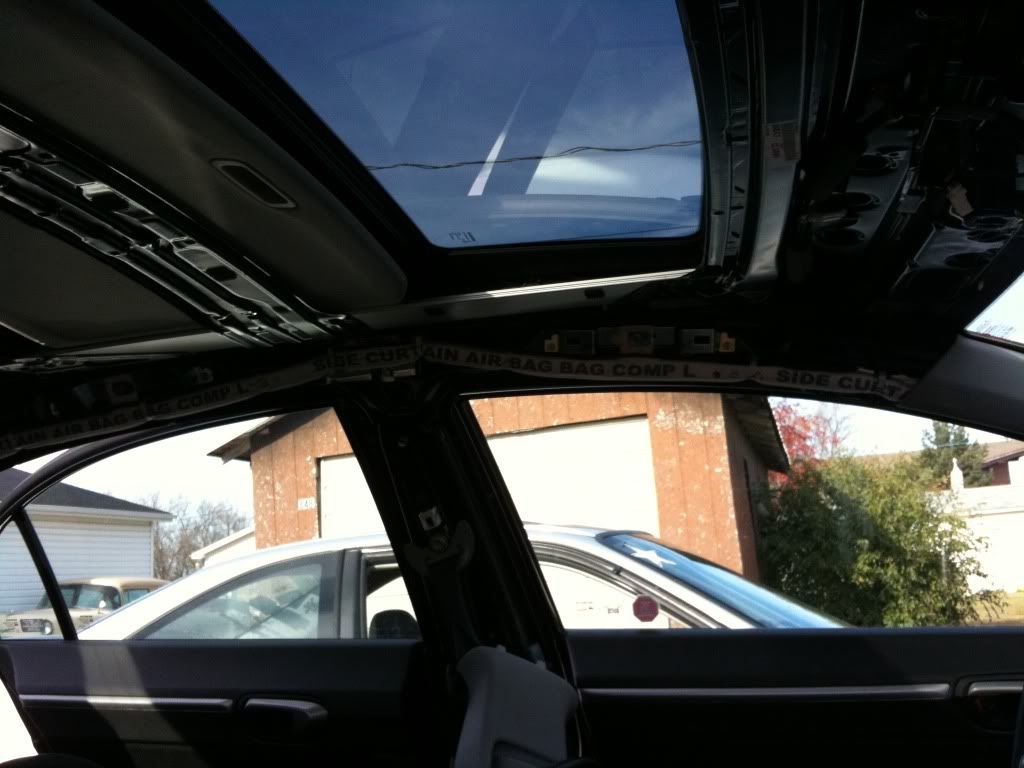

15) if u have a sunroof be prepared for a big pain in the ass. You will see 4 cords/pipes/rub running to your sunroof and away from your sunroof. Disconnect them from the sunroof. Then remove the bolts holding the sunroof to the roof of the car *be barefoot the glass will come down too and Ita not light* (tip: have your seats raised normally now and balance the sunroof on the headrests of the seats). Now pull your sunroof cover all the way forward. Tilt your sunroof back. Now using a small screwdriver (must be angled) unscrew the slider from the rear of the sunroof cover. I Disnt find a great way to remove the front slider, I kinda broke mine :(

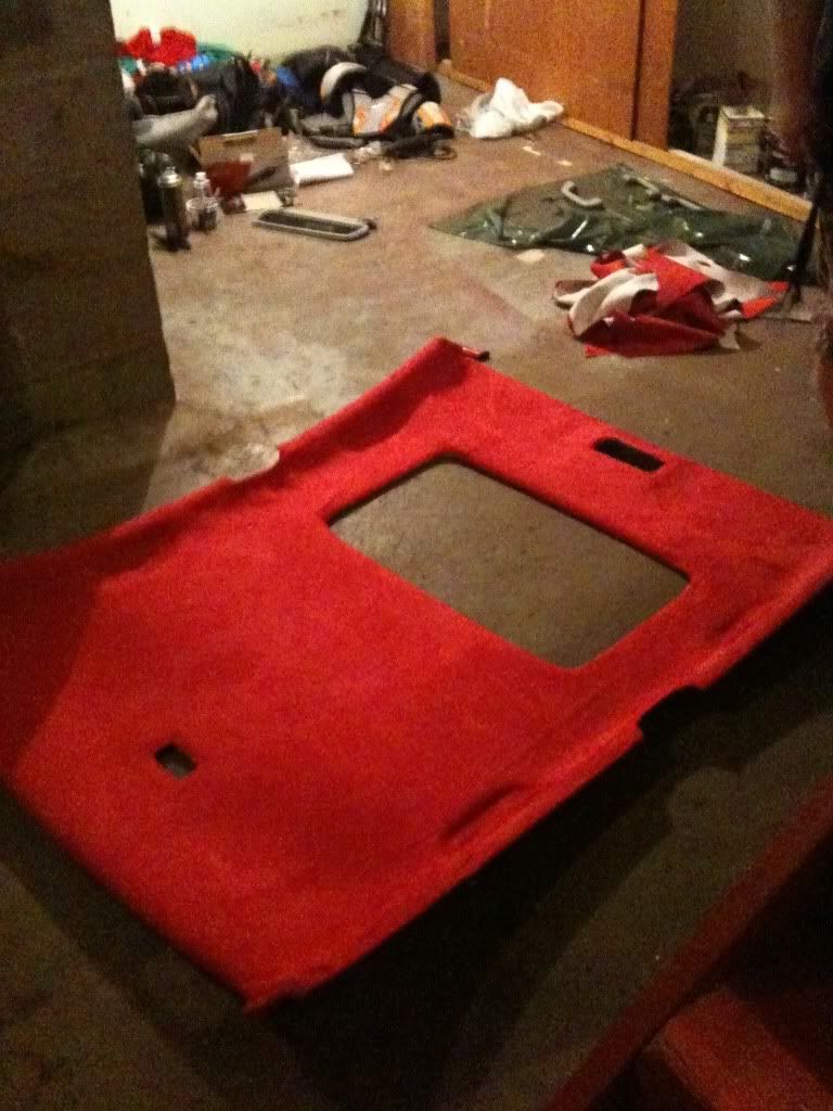

17) I used 3M super 77 adhesive to stick my fabric to my headliner. Mine didnt turn out quite like I was hoping but it's good enuf. I cannot stress enuf how much time you should take with this step. Make sure that the new liner is pressed into every crack and crevice and nice and snug to the original headliner.

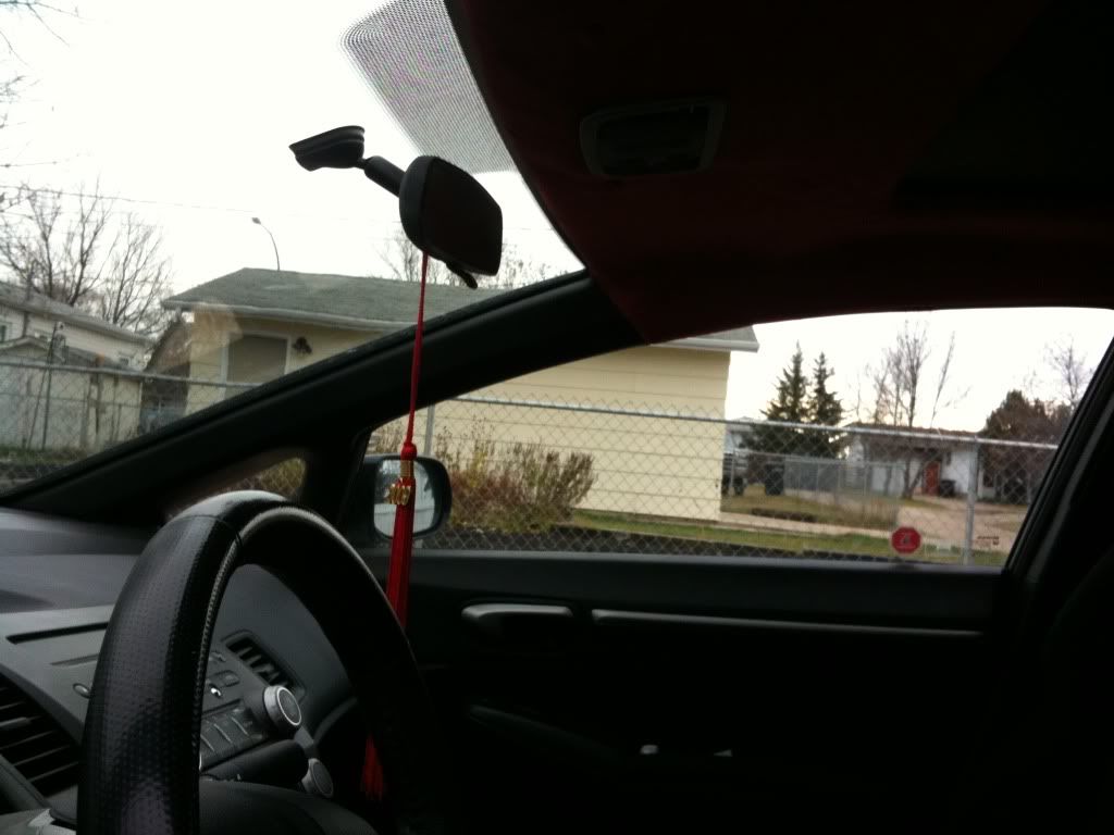

updated with a few pictures. sorry for the quality, they are all taken with my phone. i'll take a few more pics and post them in the next couple days
