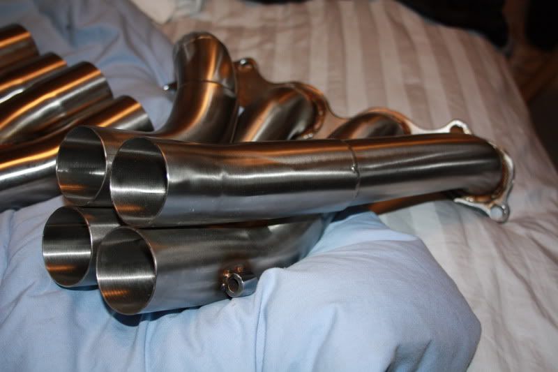

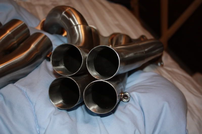

New Revised SRT RACE CUT kit (very first kit produced):
-Precision Billet 5857 Turbo, V-Band with S-cover (4in inlet/2.5in outlet)
-Ram-horn style, equal length tubular, Race Manifold, Single teardrop Wastegate
-Precision 46mm WG, SS WG dump tube to atmosphere

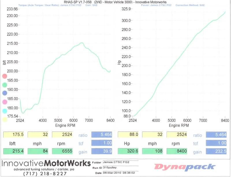

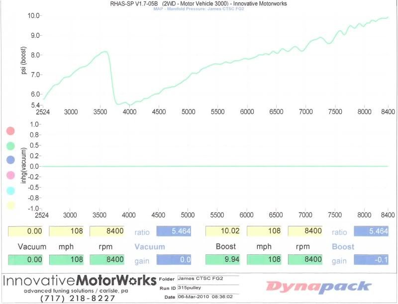

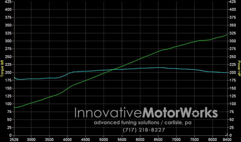

New tuned numbers by Innovative Motorworks, 320hp/215tq :woot:
Ran at the track with a personal best of 13.5 @ 105mph. Best driven by udumkid was 13.8 @ 109.98 mph so I know the car is perfectly capable of 12's. Could not get into 2nd gear for crap. That 13.5 run of mine was done with a nice pause in between 1st and 2nd
Very very pleased with the car

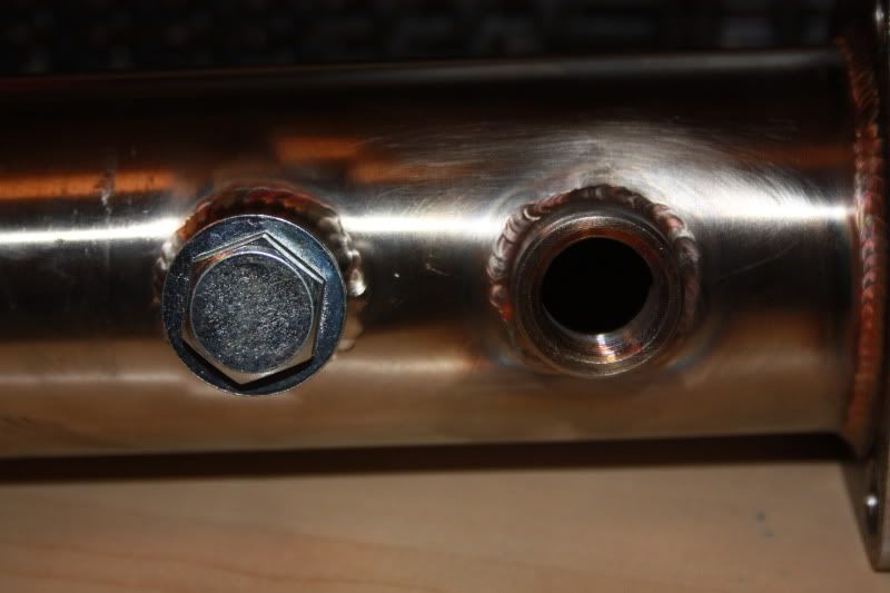

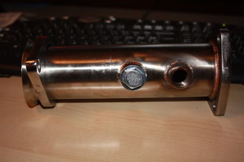

^very clean bung weld by Mach V :woot:

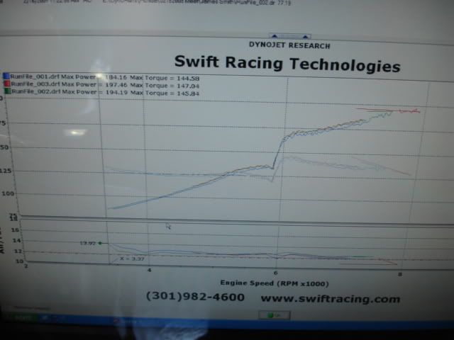

old dyno with just skunk2 70mm

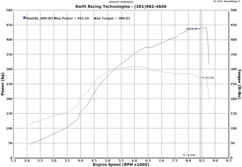

dyno vids:
pic of the chart:
these are STD corrected. so i put down about 189whp in SAE corrected.

pic of the chart:
