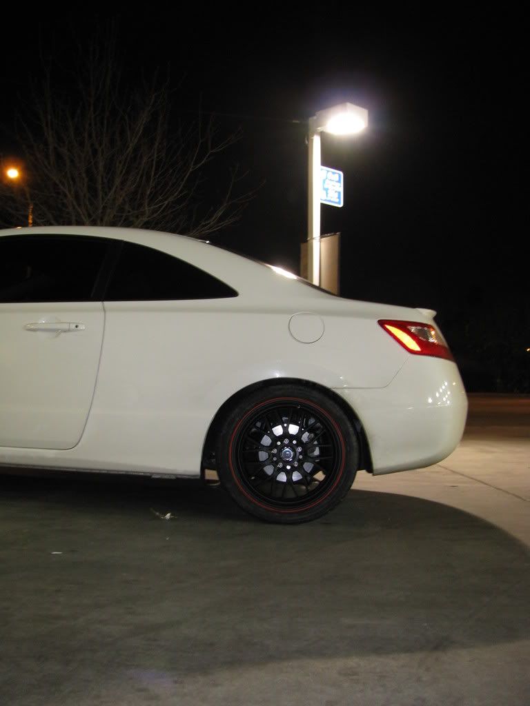

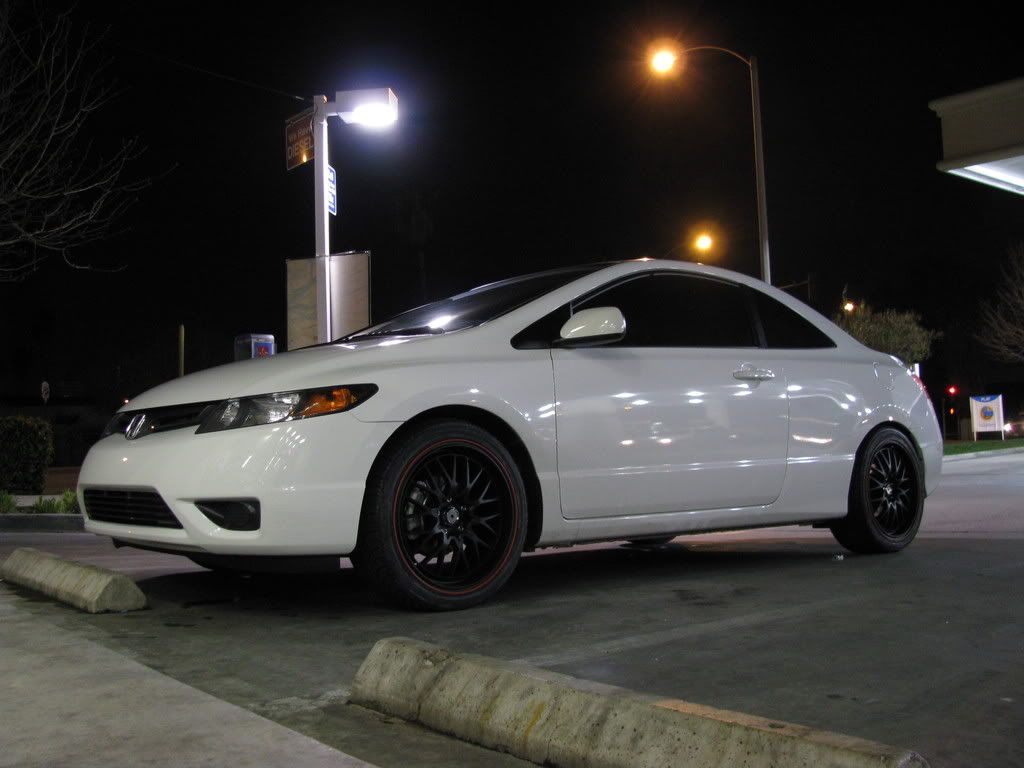

So, picked up the wheels yesterday, and also had the windows tinted friday, 20% all around. Wheels are 18x8 no drop.
Keep in mind the car looks superficially low in the rear and high in the front because we had 4 wheels and tires in the back, and bunch of other stuff. Also, stay tuned for better pictures when the rain clears up!

Thanks! They're +38 offset, which fit just about perfectly, I'm not sure how people run 35's because these rub with as low as the rear is...

Look at the post above you, I mentioned it's a +38 offset. Basically the lower the number on a + offset the further it will stick out. On an 18x8 I'd say +38 looks good. Some guys run +35's without issue though.

Nice, I run +35 on stock height and rub slightly when I turn fast or the fat friends are in the back seat. In hind site I would go with a +38/+40 et on the next set of wheels I go with. That way there shouldn't be any rubbing issues at all and they would still provide an aggressive stance.

PM'd you about offset so as not to thread jack.

I dunno, I don't think a +40 would look great. I think +38 is as far inset as I'd like to go. I'm a huge fan of flush wheels, and think +35's look great. But with the fact that these rub as much as they do, I couldn't imagine getting away with +35's without camber. As it is I'm hoping we can roll the fenders on these and it'll go away.

you need to run some mad tyte 205 width tires on those 18x8's! then you wont rub!
lol
no but seriously.. offset and width go hand in hand. a +38 offset on one wheel may not fit the same as a +38 offset on another. depends on the width of the wheel.
