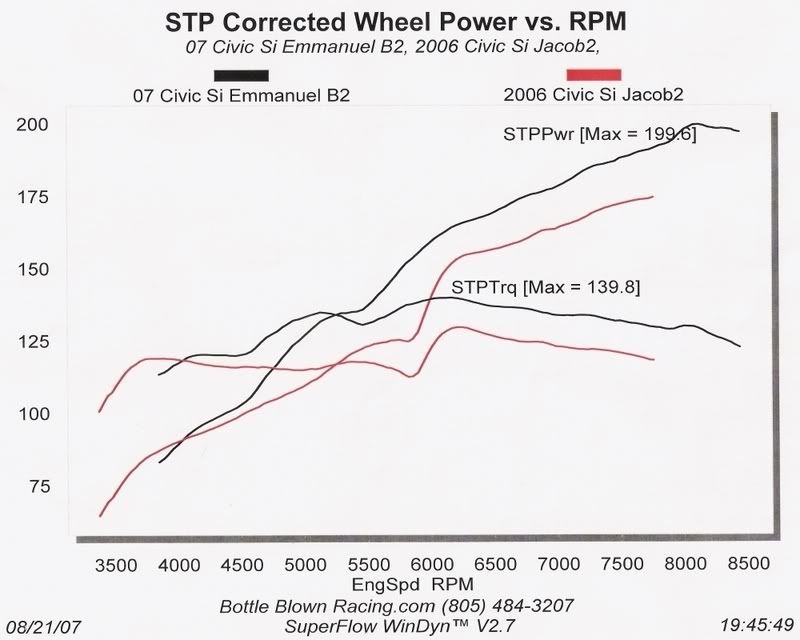

FA5 with 06 TSX cams, dyno sheets.
i decided to clean up this original post, alot of dyno sheets now with diferent combinations...
reason for all my dynoing, well my AFR's were a little lean, so im just tryin to get it all straighten out now.
here is a direct comparsion of my car and a Stock Si. stock Si's put down low 170's on this dyno, this SI put down 174WHP with 131 lbs ft, i put down 199WHP with 139 lbs ft of tq

dyno jet figures with all my mods that are listed 211WHP

the AFR leans out just right with the CAMs... so what was the problem? FUJITA SRI was letting in to much un metered air and causeing it to lean out over 1 FULL point vs the stock airbox... my findings are the diameter or the fujita is bigger than the stock airbox... and the dividers that the factory airbox have are there for a reason... i got nothing but consistant AFR through the whole power band with the stock box..

next graph here is all mods listed above with the exception of the P2R spacer vs NO spacer and NO fujita short ram...(stock box) look closely, i picked up 2 lbs ft of tq but i did lose about 8 WHP with the stock airbox but its only over 7500...
dynojet figures fujita VS airbox.... 208.9 WHP with SRI and 201.3 with the stock airbox.
ALL THESE FIGURES ARE SAE CORRECTED!!!!
