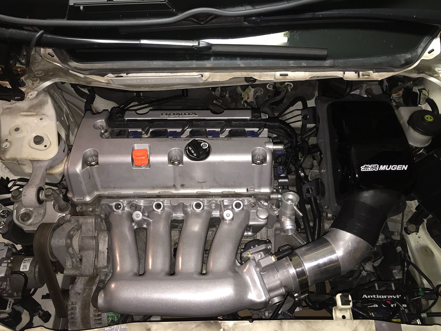

I bought the Mugen air box a couple months back. I'm deleting MAF and will be tuned using MAP readings in Flashpro (this is the norm anyways).
Some pics:
With the K&N air filter:
And after painting it black like it should be:
I did not want to use the tiny OEM intake tube, so I've had to fabricate a custom aluminum intake to connect my RRC and J35 throttle body to the MUGEN airbox.
V band flange welded to the throttle body:
And the other flange welded to a 3" to 3.5" cone transition:
And bought a 45 degree 3.5" aluminum tubing:
And cut that down to basically a nub:
And how everything looks at the moment. I will get the intake tubing painted satin black...
