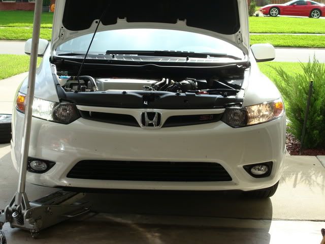

JDM side markers!! August 07
Used a dremel with a cutoff wheel ONLY. Don't try to use anything other than the cutoff wheel b/c you'll most likely chip the paint away.
OMGGGGG :SHOCKED: a huge hole!!! I was sure to paint over the exposed metal so it doesn't rust.
FOG LIGHTS! I finally got around to putting them on as well. Aug 07

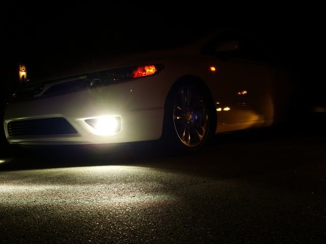

I finally got my HID's installed. I used the kit that Orient Express recommended (his post is stickied in the HID section)
5k light output for the low beams AND fogs. the fogs aren't shown tho because I haven't finished wiring them up inside yet. I want to control them so they'll come on anytime. just waiting for a friend to come help.
ANYWAY, onto the pics!
side by side comparison to stock
I also installed my custom battery tie down by Celcius. "anjeru" is my car's name. It's the romanization of the spelling of "angel" in Japanese although tweaked a bit. (b/c proper way is einjeru)
Thanks to sleeperone I got the fogs wired up to come on anytime, and with the HID's in there it's extremely sekzy
not a bad cutoff for a cheap kit
