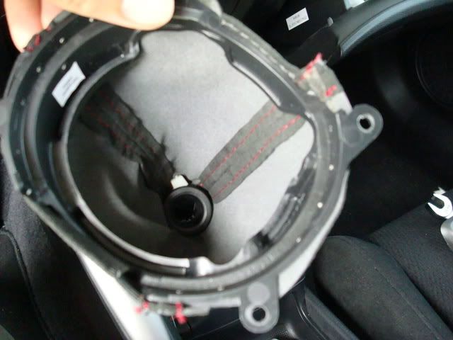

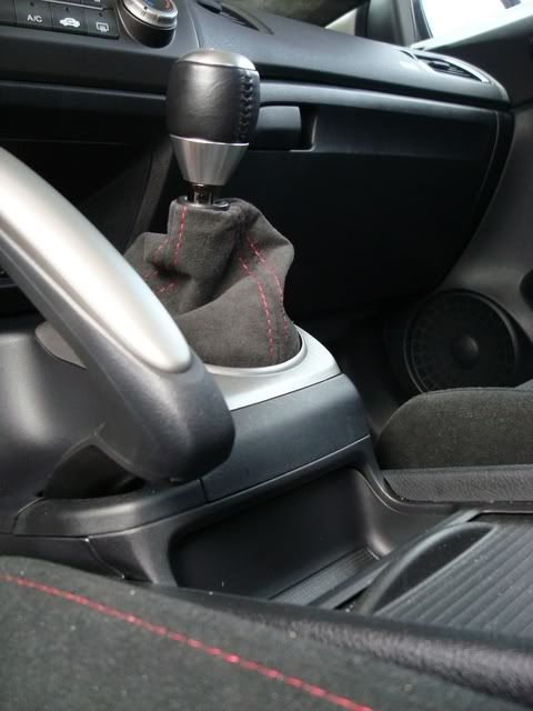

AUGER Shift Boot, black suede w/ red stitch
The stock one..
Such an easy install. I went ahead and did the TMW SS while I was in there.

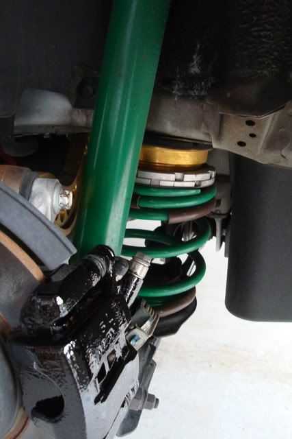

They are here! TEIN Super Street Coilovers with EDFC!
mg: Also added SKunk2 rear camber arms in gold. Late may 07
Before the install...
:SHOCKED:
Aftermath! I can still drop it about an inch or so.

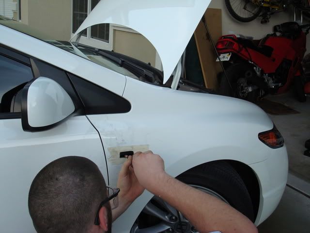

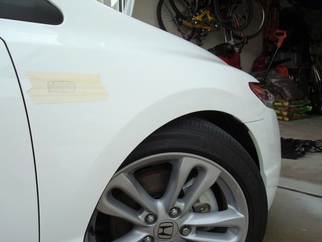

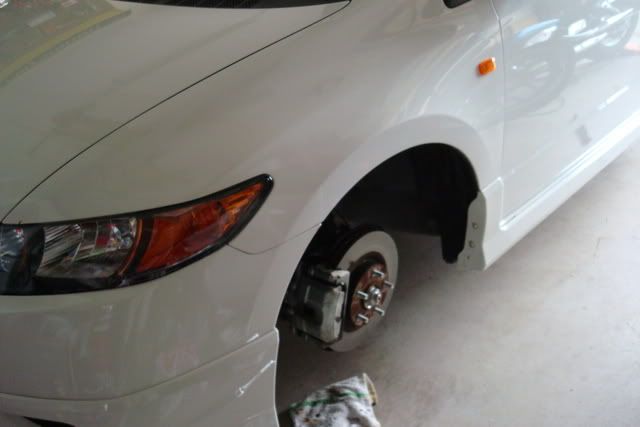

JDM side markers!! August 07
Used a dremel with a cutoff wheel ONLY. Don't try to use anything other than the cutoff wheel b/c you'll most likely chip the paint away.
OMGGGGG :SHOCKED: a huge hole!!! I was sure to paint over the exposed metal so it doesn't rust.

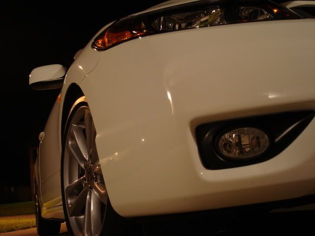

FOG LIGHTS! I finally got around to putting them on as well. Aug 07

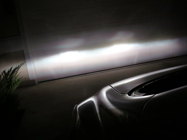

I finally got my HID's installed. I used the kit that Orient Express recommended (his post is stickied in the HID section)
5k light output for the low beams AND fogs. the fogs aren't shown tho because I haven't finished wiring them up inside yet. I want to control them so they'll come on anytime. just waiting for a friend to come help.
ANYWAY, onto the pics!
side by side comparison to stock
I also installed my custom battery tie down by Celcius. "anjeru" is my car's name. It's the romanization of the spelling of "angel" in Japanese although tweaked a bit. (b/c proper way is einjeru)
Thanks to sleeperone I got the fogs wired up to come on anytime, and with the HID's in there it's extremely sekzy

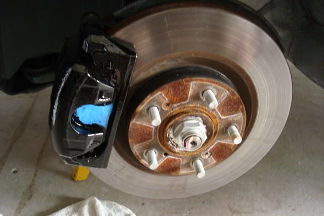

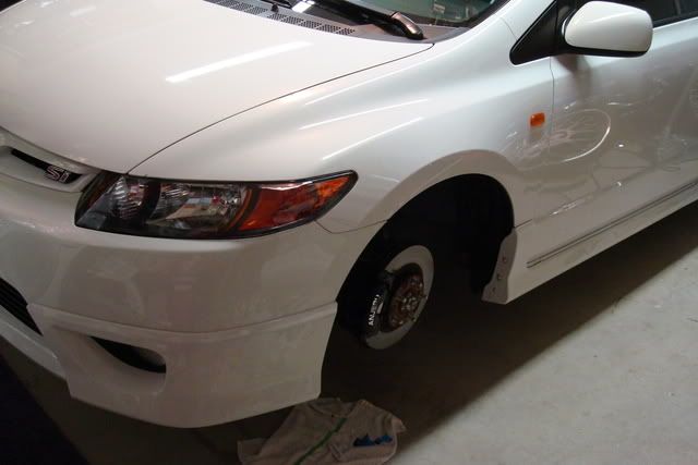

Calipers Painted and custom decal's added this week.
- G2 Caliper paint
- Chrome decals by GrafiXpressions
I used some brush on clear touch up paint to cover the decals after installing them so they won't come off or get damaged. I was told the chrome letters don't stick so it was an easy solution for me.
onto the pics!
Before
After
In Process

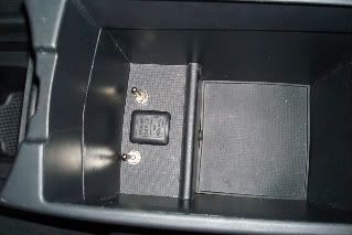

LED's and Courtesy lights added!
I used like 6" white neons under the dash for ambient lighting. One on each side.
Then I used a couple RED LED strips for the dash and a couple single LED's for the cup holders. I want to add an LED strip in the cups of the door handle too. I ran the wiring for them up to the console, but not into the door yet. I figured I'd wait till I do my Component speakers before I run the wires since it's a PITA.
Pic of where I mounted the switches
Now the details on wiring.
So it took me forever to figure it out b/c I'm not a wiring GURU. I wanted them to work EXACTLY as the dome lights do, but I also wanted independent control over them, so after figuring out I need a 6 prong switch that has TWO on positions, and center is off. Leave it in #1 on position and it acts with the dome lights, leave it in center and it's always off, leave it in #2 on position and I can turn them on anytime. :thumb:
Plus on top of that, I have the RED and WHITE lights separated by the switches, so I also have independent control between the colors.
mg: :cheerleader:
You have to think backwards when wiring them this way because the dome acts off a ground only. It has constant power, so I had to reverse all the positions of where the wires connected to on the switch.

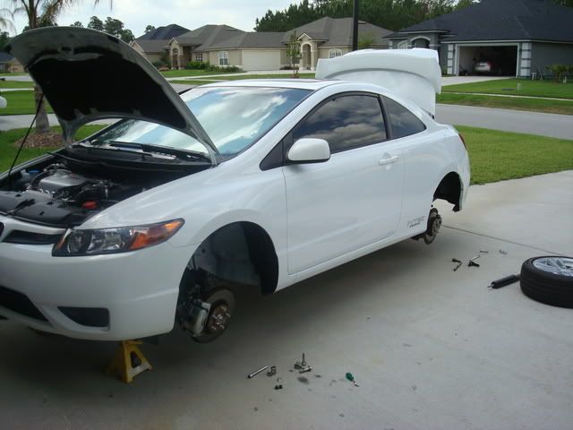

- Got a fender roller and started doing the rear fender. Got one done. The lip OEM in the rear is nearly 22mm :shocked: I was moderate and got them down to 13mm. I moved a bit fast with it though and the paint started splintering on the inside lip so I gotta sand it down and airbrush it. Thank god I know how to do that. It's unseen anyway although it won't matter b/c I'll make it look like it never happened. It's not that bad anyway even if I left it alone. But over the years or however long it takes I don't want it to start flaking off. :xyxnervou
UPDATE: Did both the rears. Came out pretty nice. I took more time on the other side and had less cracking but still had some. I taped off, sanded and airbrushed both sides already.
In progress. (right side not rolled yet, left side in progress)
WHAT A DIFFERENCE!!! Before I was cambered in to where it barely cleared now I can fit two fingers between the fender and wheel. Amazing!

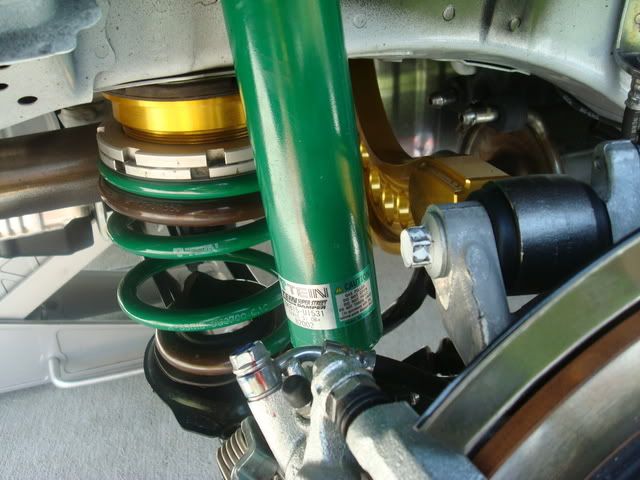

:SHOCKED:

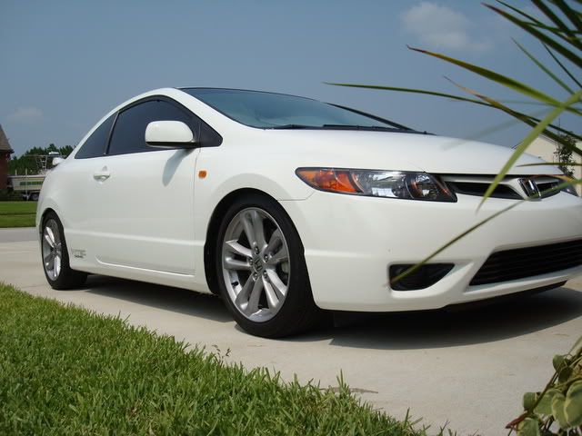

I found this pic from an AutoX I when it was still nearly stock. Only had the tint and coilovers at this time.

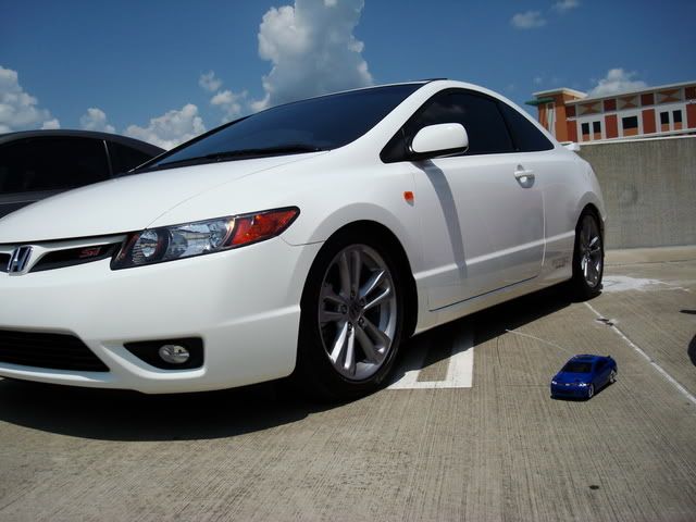

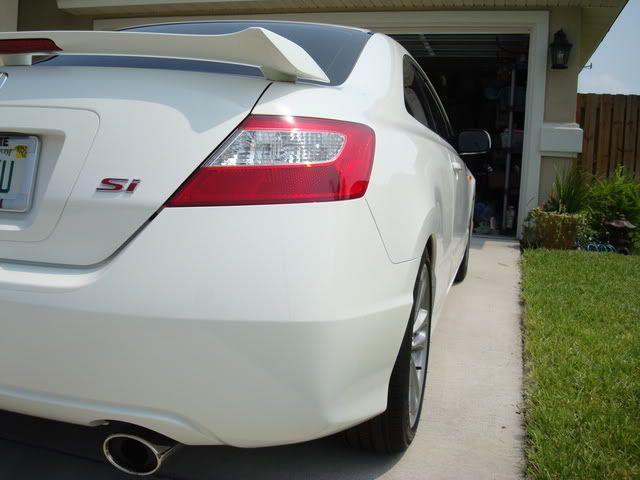

Also cleared the tails (but I have since installed the red-outs)

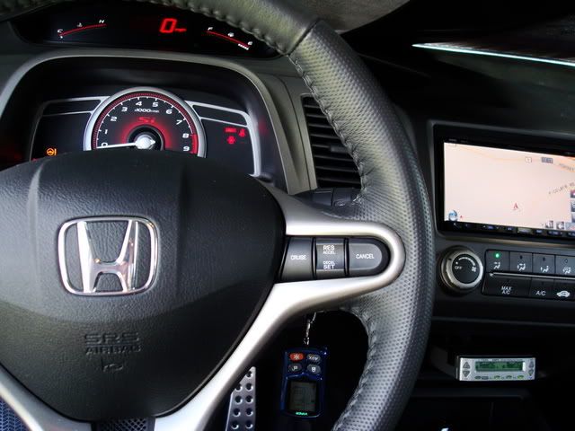

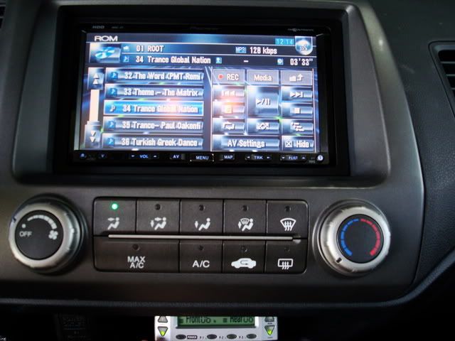

Oh wow... I got an great deal on an Avic-z1 w/ dash kit!
Also got the Viper 5900 installed. Sorry no pics. It'd be boring. :biggrin:

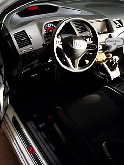

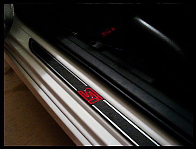

The Si Door sills are here! Thanks to Celcius for making an awesome product.
Also added....

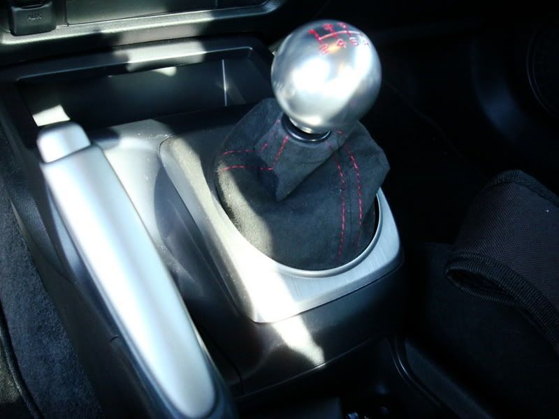

FD2 Shift knob. I removed the lock-bolt so it'll sit lower and look cleaner.

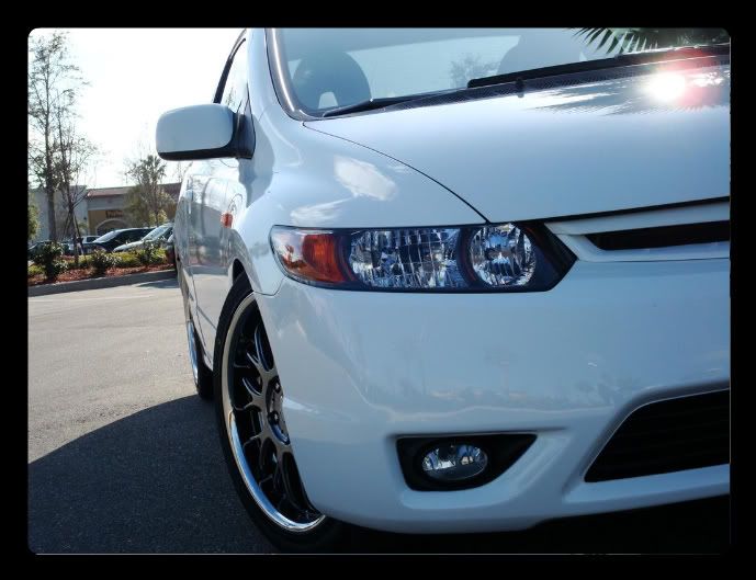

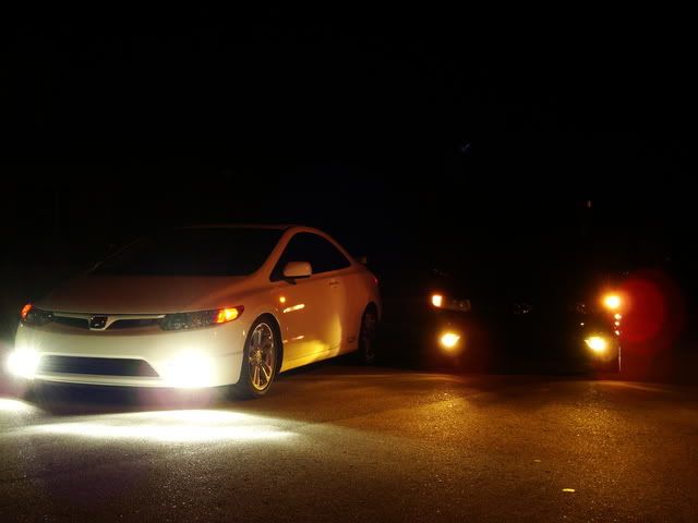

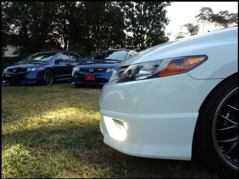

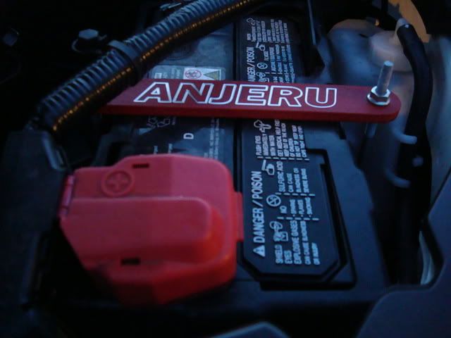

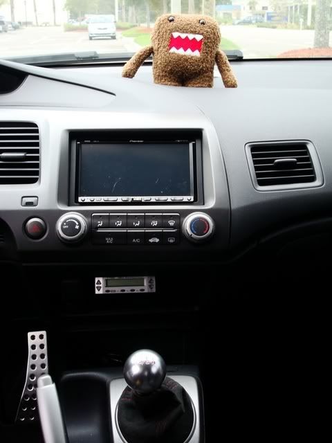

I also got a new mascot, domo-kun!

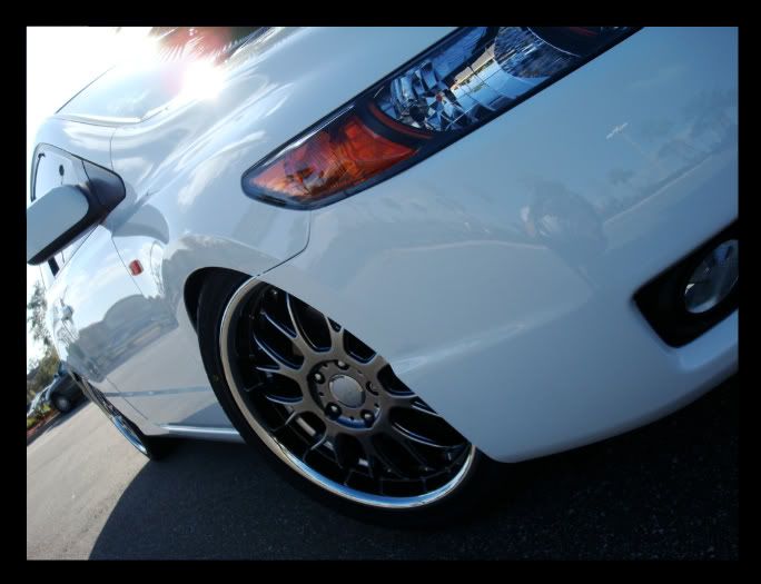

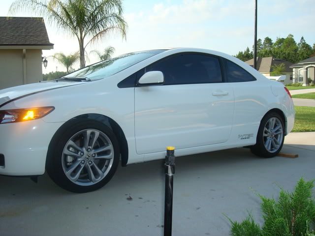

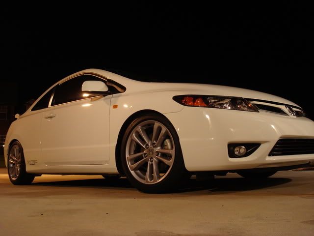

OMG, I JUST GOT NEW 18's!! 5zigen SC3000 in Hyperblack. @[email protected]
I installed the rims today. :woowoo:
- G2 Caliper paint
onto the pics!
Before
After
In Process

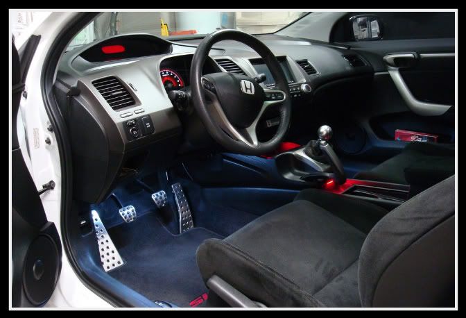

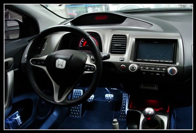

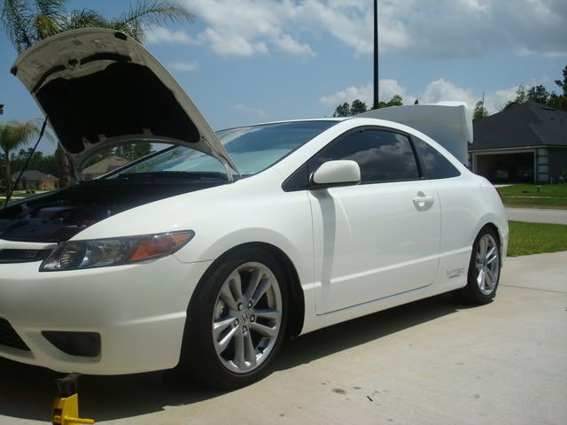

Decided to just go for it.
Got a GReddy Turbo kit w/ a few upgrades and installed it over spring break. Didn't have too many problems but it was a headache as it was my first turbo install EVAR.
Also splurged and got the Gram light 57pro Titan in 18x8 +38. So instead of buying wheel spacers to make my old wheels look better I just bought new wheels. : These moved the wheels out nearly 17mm more than my old ones. Had some rubbing issue's. x_x Nothing bad tho, just the front tabs that hold the plastic fender liner in gotta be bent in a little. Took like 10 seconds to fix that.
In progress on the turbo install

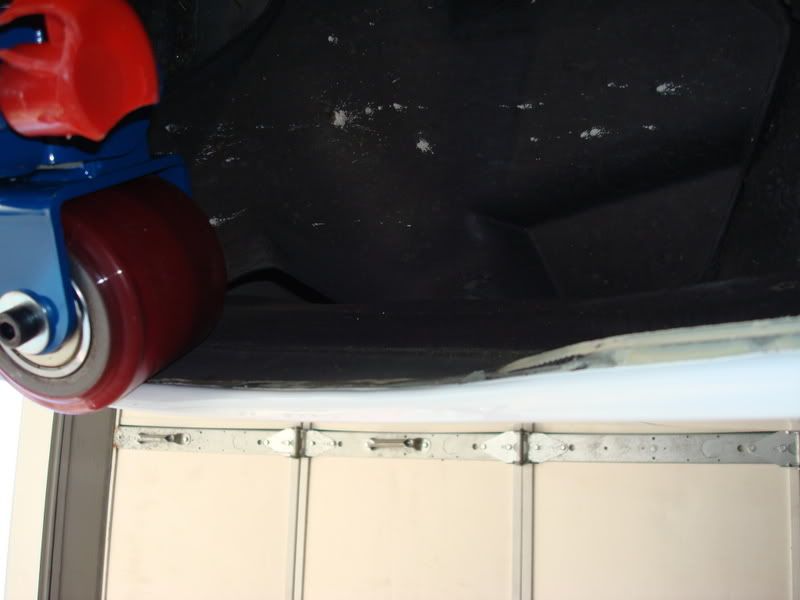

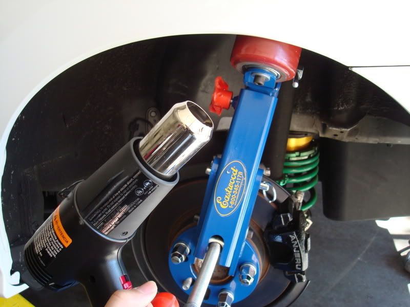

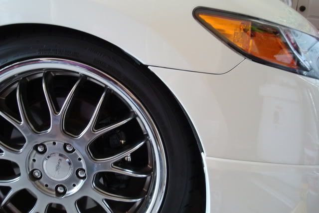

Mmmmm

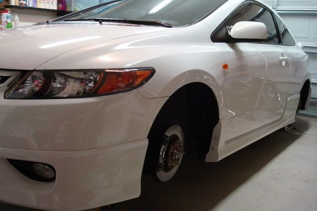

SPOON calipers installed! I had to turn these upside down to bleed them since when mounted the bleed valve is pointing downward and the air couldn't escape.
