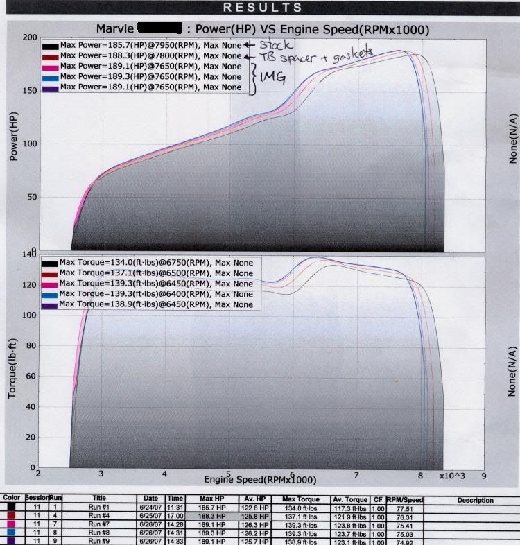

Mods: P2R throttle body spacer, 2 P2R throttle body gaskets + P2R IMG added
Temp: 94-F (2 degrees hotter than above)
Numbers: 2007 SAE corrected
Car: 2007 FA5
Mileage: 2598
Oil: Stock @ 50%
This graph shows Stock VS TB spacer + gaskets VS newly added P2R IMG as indicated on the graph :thumb:
some will say well the gasket only gives like 1whp and 3wtq?? just keep in mind that's at the peak ... look at the whole graph :thumb:
also watch how consistent the numbers are after back to back to back runs ... power hardly decreases if any which means the car is being kept cooler. As everyone knows the numbers tend to go lower as the runs increase :thumb:
again power from bottom to top ... and keeps consistency

hey Marvie, I noticed something in your graphs...
It looks like in all of the runs with the spacer and gaskets and whatnot the throttle is being released just a bit earlier. Look at the stock graph where the power and torque suddenly drop off and compare that to the graphs with the added parts. It looks like there's another couple hundred rpms you could hold out for on those.
Not that big a deal, but you could potentially see another couple hp for your peak...
9,601 Posts
Discussion Starter #18
well ... i guess ...
but it's the shop guys driving it on the dyno ... i just watch ...
that's more good news for u guys ...
18,265 Posts
F.I.A.T said:
the dyno cuts off when the brake putton is pressed not when the car actually hits the rev limiter per say.
exactly what i said b4....
they just hit the button later on the original stock run he did...
