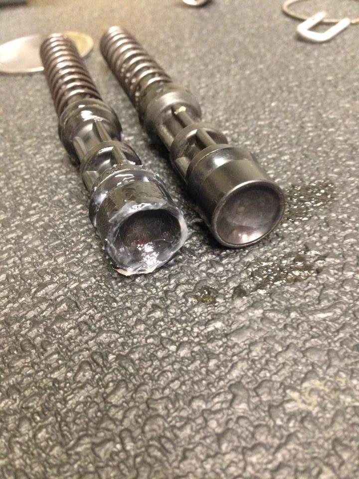

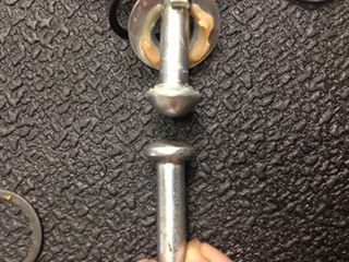

i have not been here for a long time but this issue has been bothering me with numerous morons telling me they all need EM1 cmc's to avoid lock out on high rpm shifts. i finally just made a video on how to properly adjust both your pedal and the factory CMC.
keep in mind that i have never tired the EM1 CMC on my car since i have never had a reason to try it. i have installed them and uninstalled them on numerous cars because people are hardheaded and don't like to listen.
please forgive me for the iphone video

new pivot arm TOP old pivot arm BOTTOM
new plunger/piston LEFT old piston RIGHT

holy piss now i feel like a jack a$$ for buying a EM1 CMC and throwing away the stock one! so what would you suggest I do? should I just get a stock one as soon as I have the money and adjust it how you put on here?
i highly recommend getting the updated part number but if your absolutely stuck with the EM1 which is the case with most people that have converted i have made a video on how to adjust that one.
