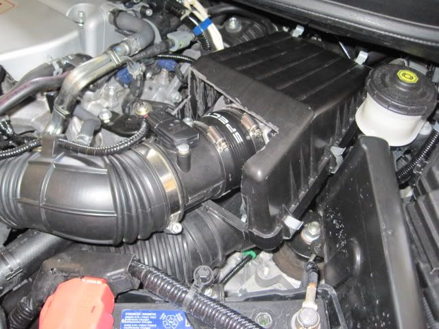

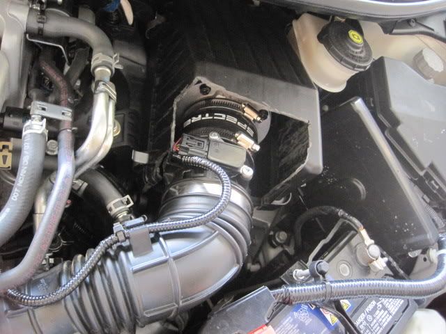

hey i have an x intake but i ve added a jeaintake style "heatshield" to it. basically i kept everything the same as an x intake but kept the original airbox cover as a heatshield and clipped it back on. i didnt force the air filter in or anything, theres no damage to the filter or around the filter becuz i dremeled out the inside of the airbox cover as u can c in the pics. but how efificient is this? does it matter at this point whether i have the "heatshield" or not? does it increase air suction or anything? thanks
parts used: 80mm apexi air filter, spectre coupler 3", and dremeled out oem maf sensor

Not really- you're still drawing air from the back of the engine where the header is. To make the heatshield effective, you'd need to surround it to manipulate where the air would be coming from, for example, cooler air from above the cowl area.
If you have flashpro, you could monitor the IAT's before and after to see the difference your intake makes.

i c, hrmm i guess for aesthetics reason, i should take off the cover lol? btw to the above poster, i bought a fujita intake, and a k&N and this is by far the best setup i have so far, no rpm bouncing or boggin. btw isnt it also drawing air from the bottom area behind the bumper since i left the bottom intake hoses attached to the lower airbox on?

Don't think the setup is efficient, because part of the reason for using the apex'i 80mm is the increased surface area of the filter element. If the filter is tightly fitting inside the box, then that's that much less of the filter that's being used. Something like CT engineering's heat shield would probably be better imo.

mine is a little smoother, i used a fujita filter, and the HPS hose.
when I compared my IAT's to what JEA was getting with his CTE short ram heatshield, we were about the same amount above outside temperature w/driving.
