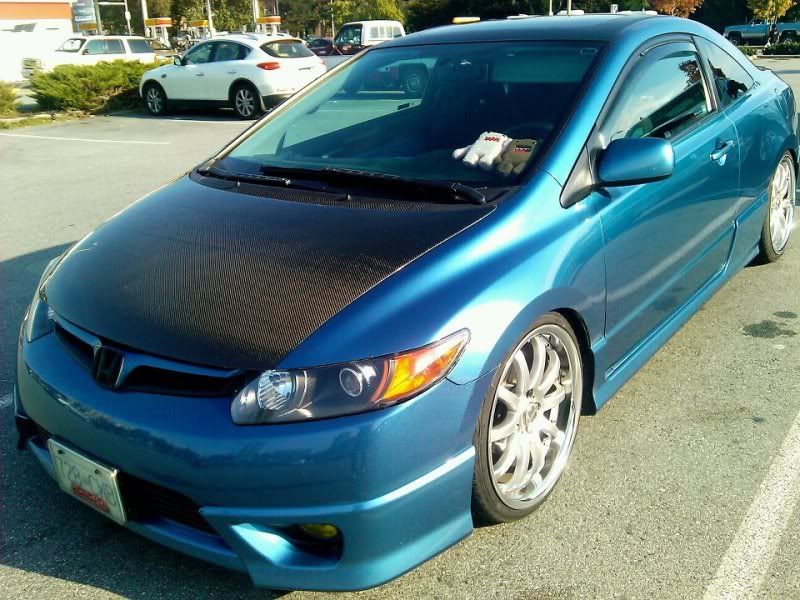

this is my gurl
thanks, she is my pride and joy next to my dog Jack.
