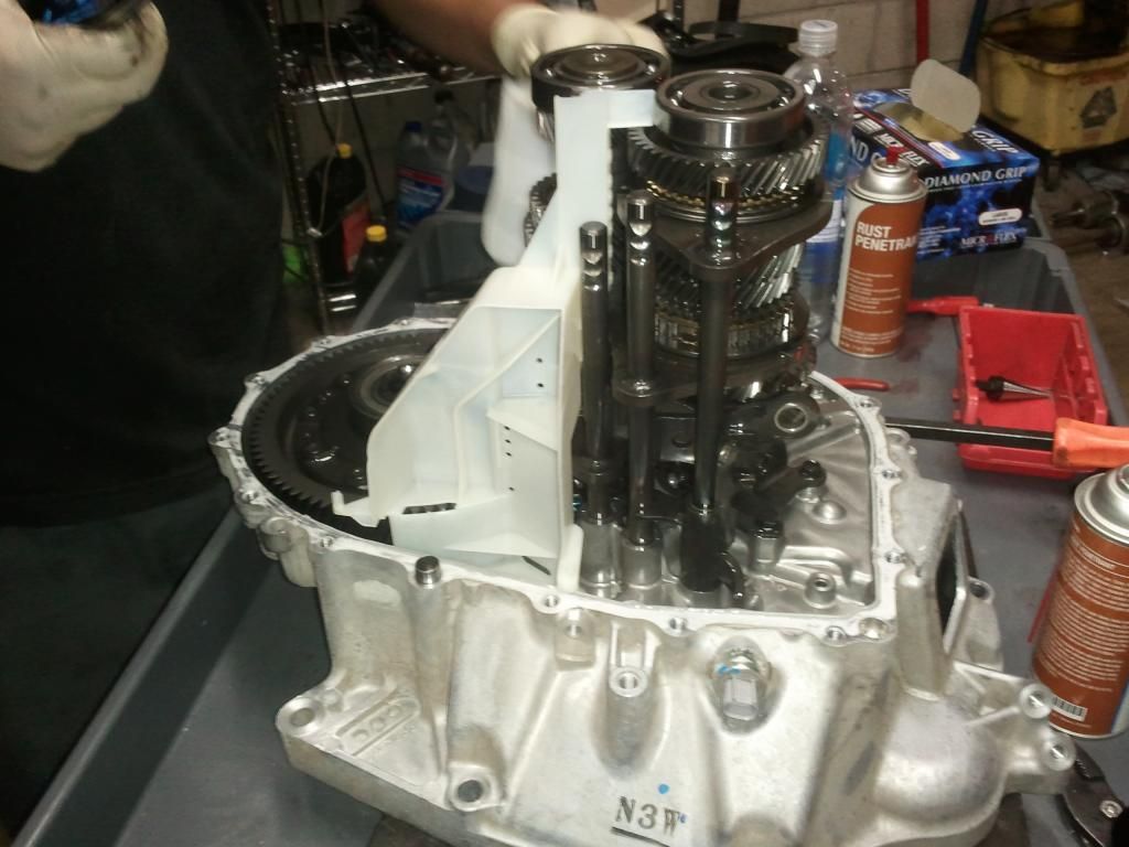

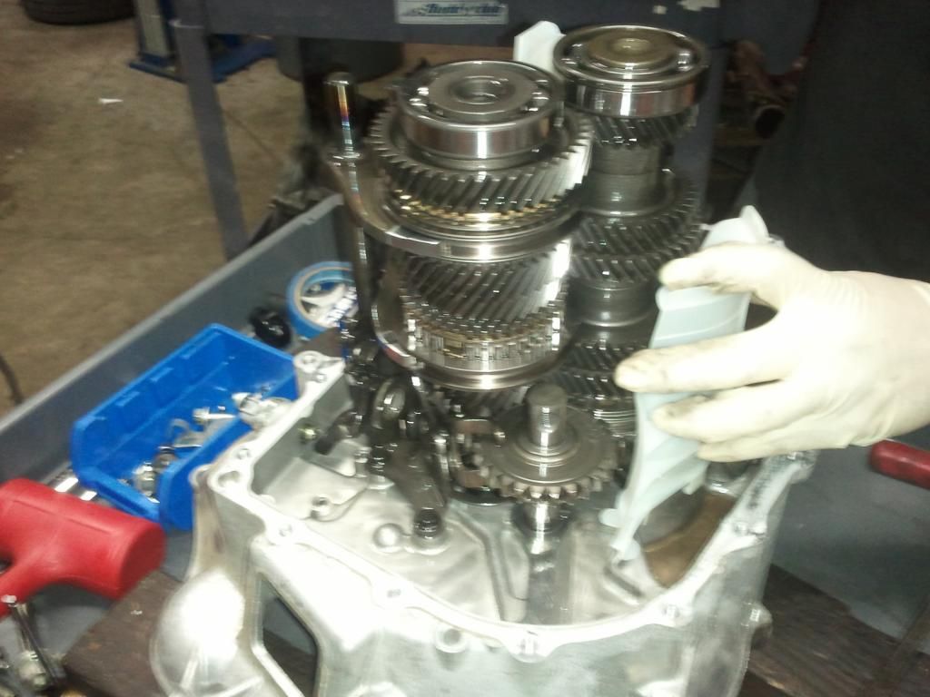

CTR final drive & integra type R (rsx) 4th and 5th gears

Nice to see people starting to use the FD2 Oil Trays in the transmission now... ;)
I wonder if it will make the windage loss even less :think:
I used the factory oil gutter instead. The clutch case needs to be modified to use the baffle
