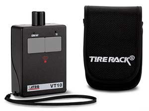

ATEQ VT10 Universal Trigger Tool
I have not used this tool but the site says it world on Honda's
i wish i could find the thread... but i believe that product has been discussed before and found to not work for our cars.
however, at merely $105, i guess it couldnt hurt to try.
Since the Tire Rack is a site sponsor, it might be a good idea to contact them via their forum and ask if they can try it personally or if they will allow you to return it if it doesn't work.
