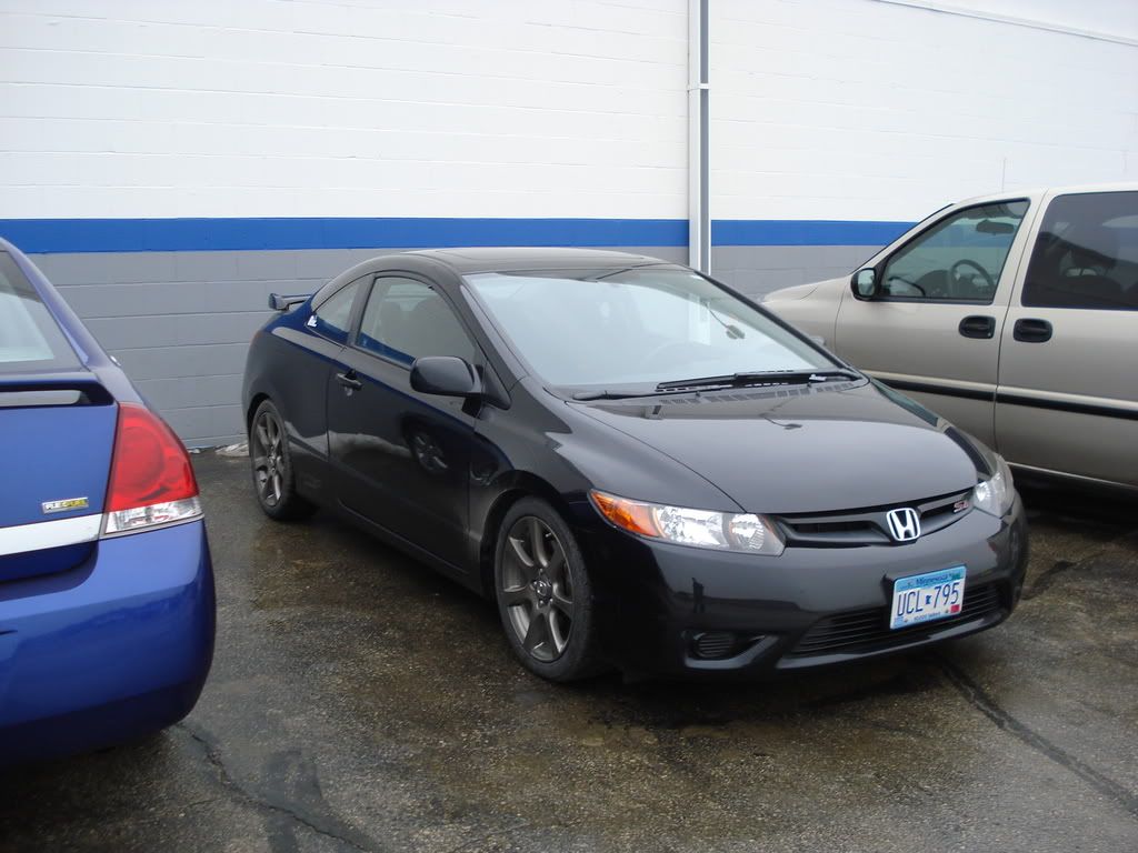

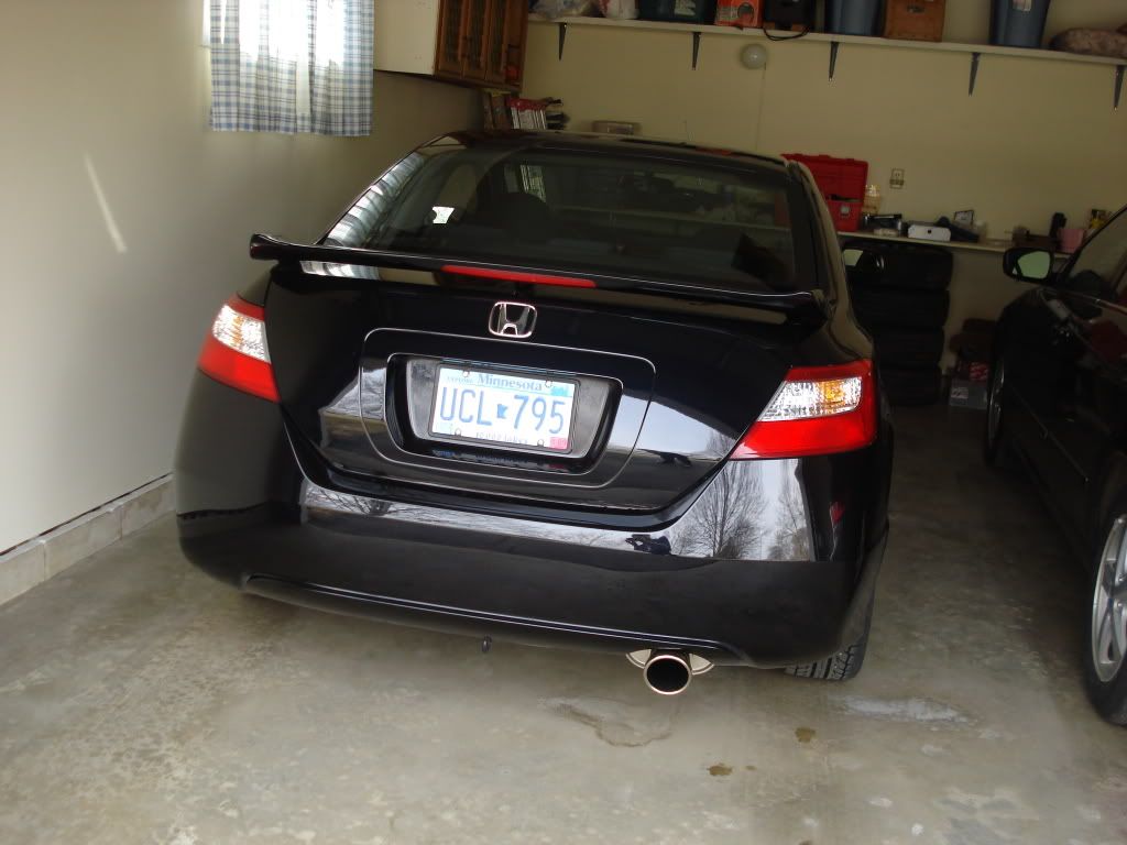

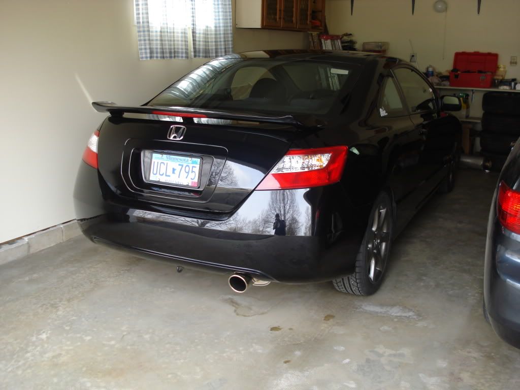

Decided since im getting my car all buffed up and pretty next week id debadge it
imo it looks way better also added a few things
215/45/17 BFGoodrich Gforce sport's
HFP Carbon bronze rims ( thanks collegehillshonda.com )
SPC rear camber arms
Eibach Sportlines
Vibrant catback system

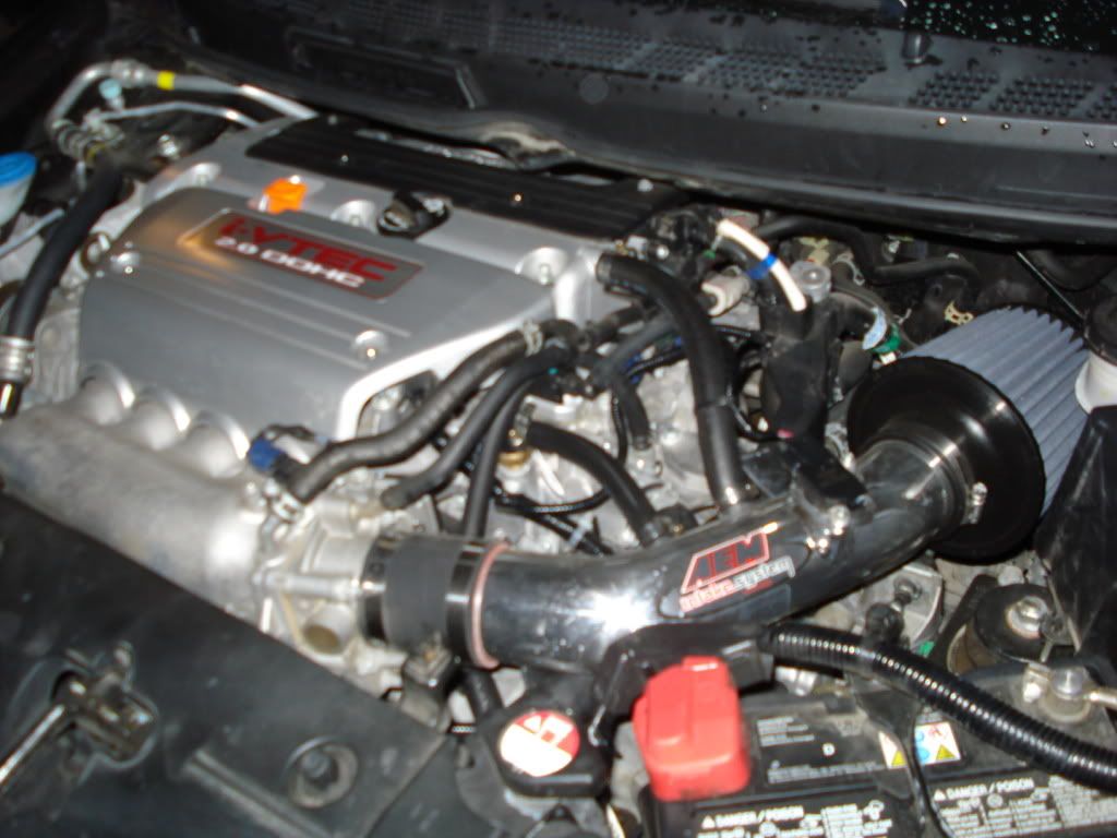

AEM short ram ( ordered wrong color lol )

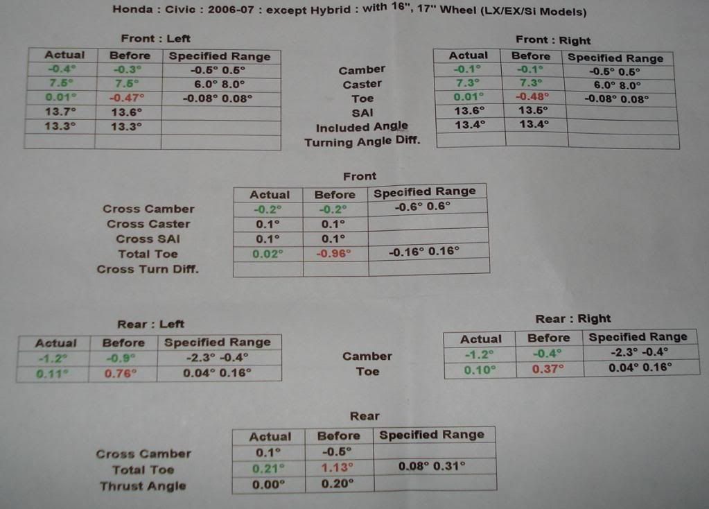

Heres how messed up it was with eyeballing the camber adjustment with the new arms, i got it aligned the next day..car felt very awkward when hitting bumps..
