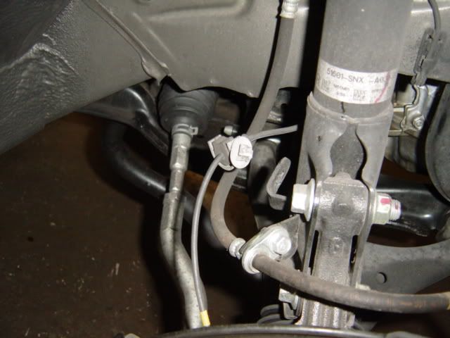

6) Unbolt break line and clip off ABS sensor.
Here's what you get after completing step 6.
