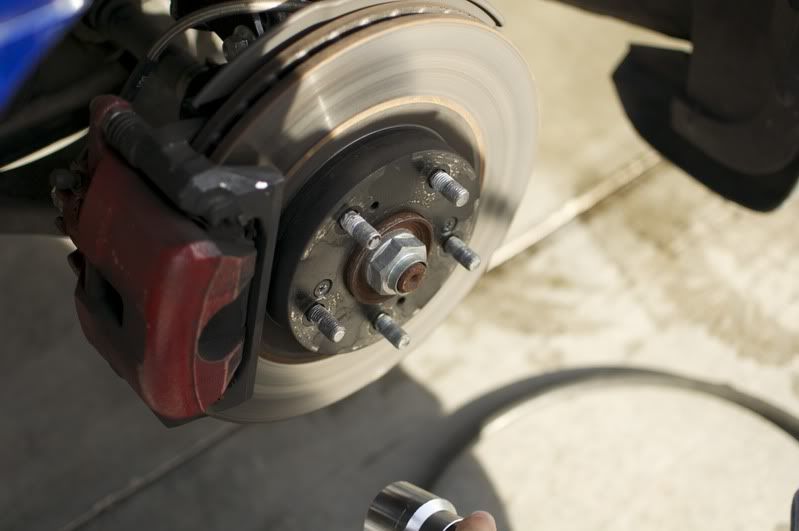

Started off my getting the car in the air and taking the wheel off.
We then preceded to take the axle nut off because it make it easier to take the LCA off the car.
