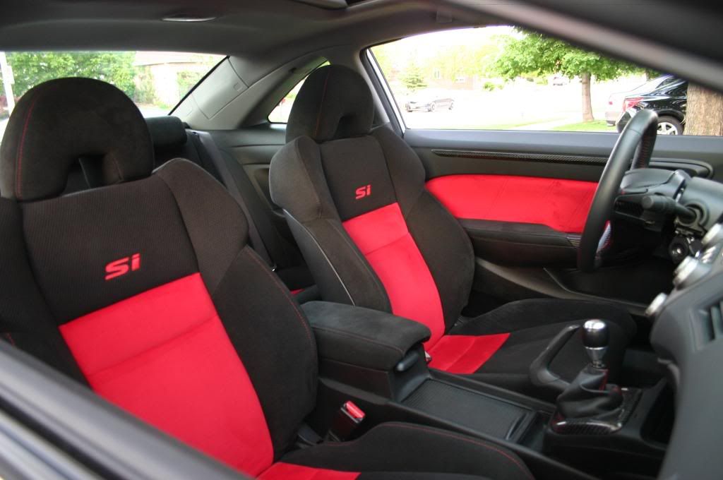

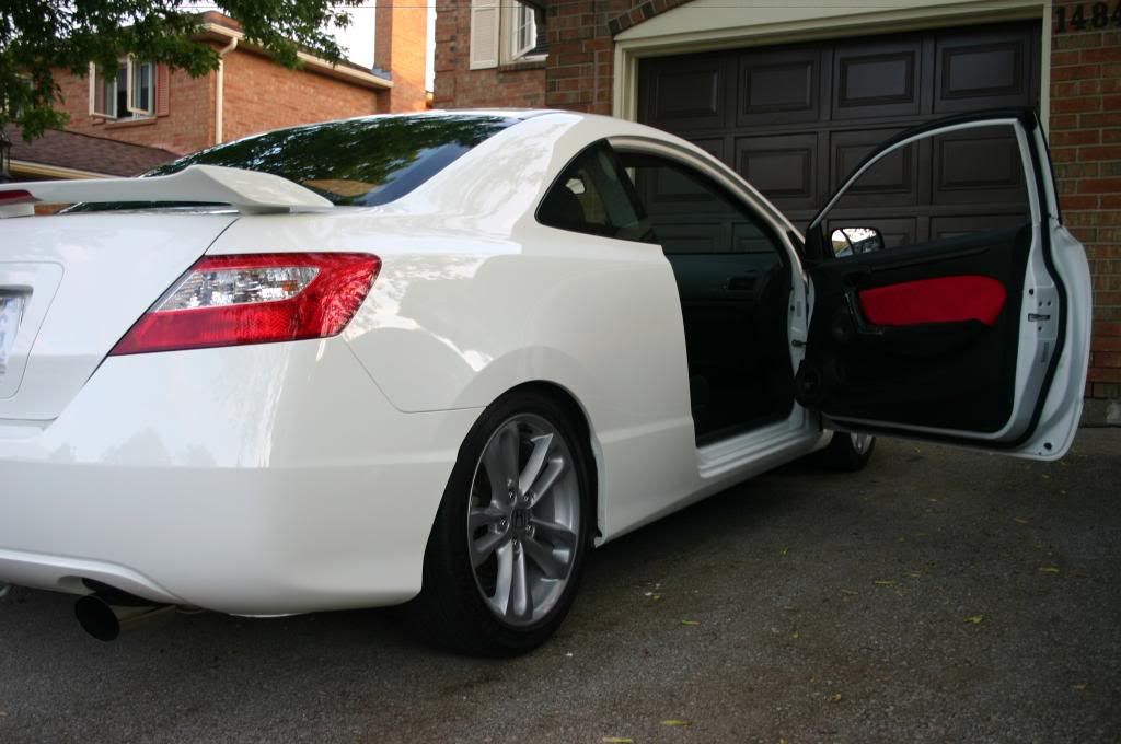

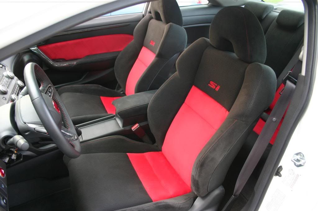

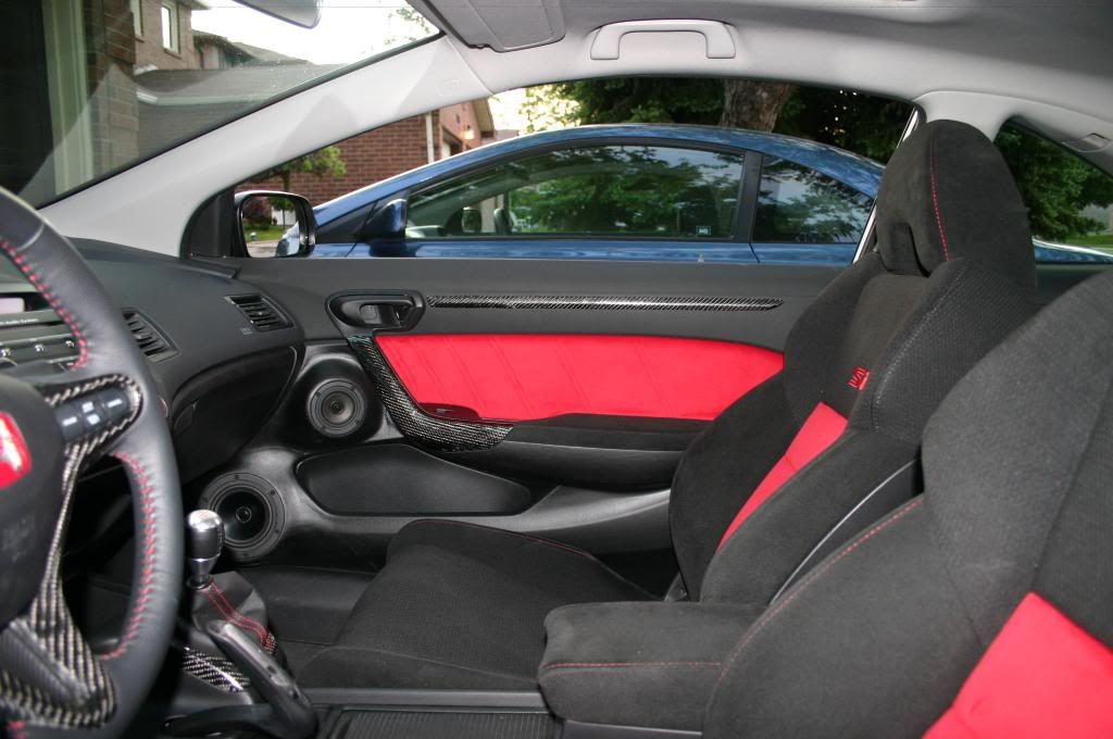

As promised, here is the DIY for the seat material change. I replaced 4 panels on each seat, and to do it, you basically have to dismantle the entire seat, which is harder on the front seats because there are more safety devices. As you can tell from the thread title, this DIY is a great complement to esx005's red door panel mod.
The material I used is plush synthetic kind of like a cross between velvet and suede. At $17/yd, it's much cheaper and IMO, likely to be a lot more durable than Alcantara/Ultrasuede. And it's a perfect match to the "Si" logo on the seats!

*EDIT 5/22/09* Finally got some finished pics, so I replaced all the old ones :)
Comment/criticism/questions welcome! :wavey:

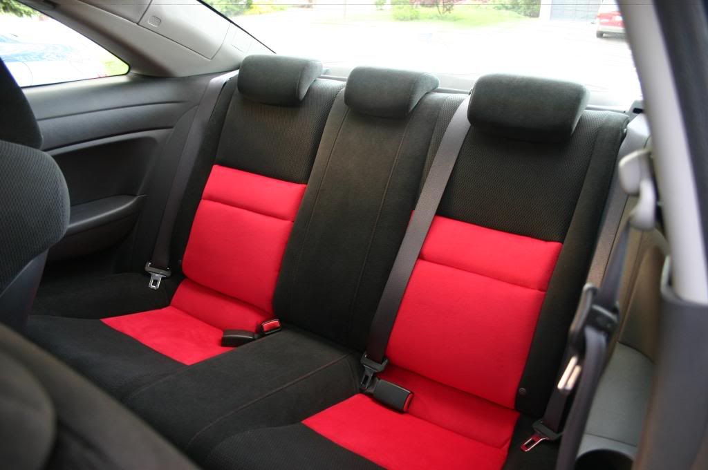

It took me a weekend for the first seat because of all the practice runs and experimenting with the material and the sewing machine, and another weekend for the second seat because I had a mild disaster... basically I started using too much glue between the foam and material, which was causing the thread to break every time we tried to sew it. I ended up lubing up the needle with a bar of soap to make it work. But yeah, only put glue one one side only! Don't repeat my mistakes :p

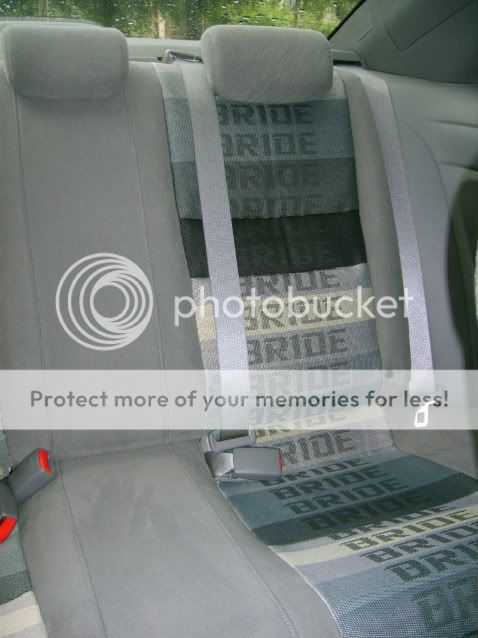

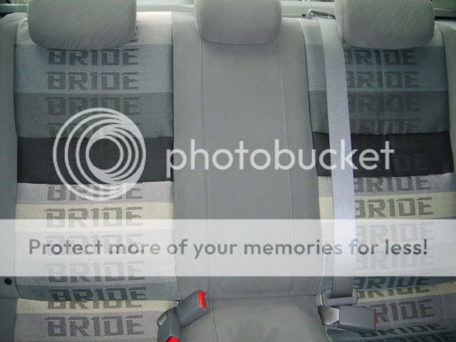

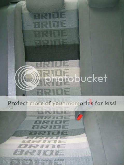

I managed to do all the rear seats in about three days. The rear seat backs are relatively easy, but the rear seat bottom is a ***** because of all the dogs in it.

^ Oh yeah I forgot to mention that. The interior is pretty much gutted until early spring due to a bunch of projects at the same time. I'll definitely post pics when I get everything back together.
