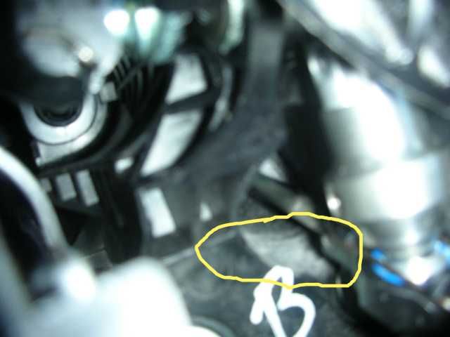

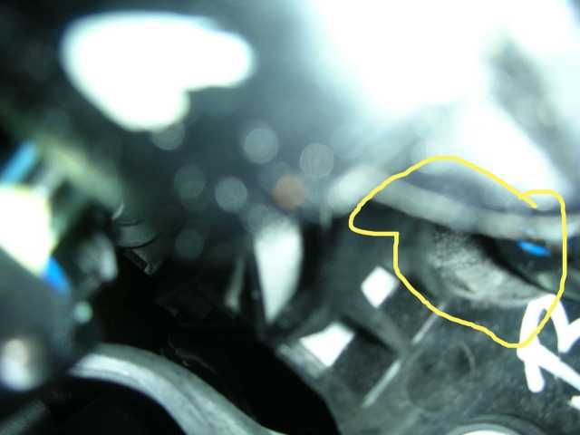

7. now this is the part i haven't seen any one else do. (after installing the first one we noticed that the short shifter causes the cables to rub against the base of the shifter making it harder to throw it in 2,4,6, and R) so to remedy this all you need to do is get a dremel tool or file or hell even a butter knife could probably get the job done and just grind away some of the plastic that is on the base to give your self a good smooth shift. this may require a few times to get rite but there isn't much that u need to take off just a bit off the bottom edge will do it.( if unsure skip this step and come back to it after installing it so you can see were it hits)

u can see were i shaved away some of the plastic
and here u can see how close it is to the base. befor i shaved awa some of the material it would rub against it.
