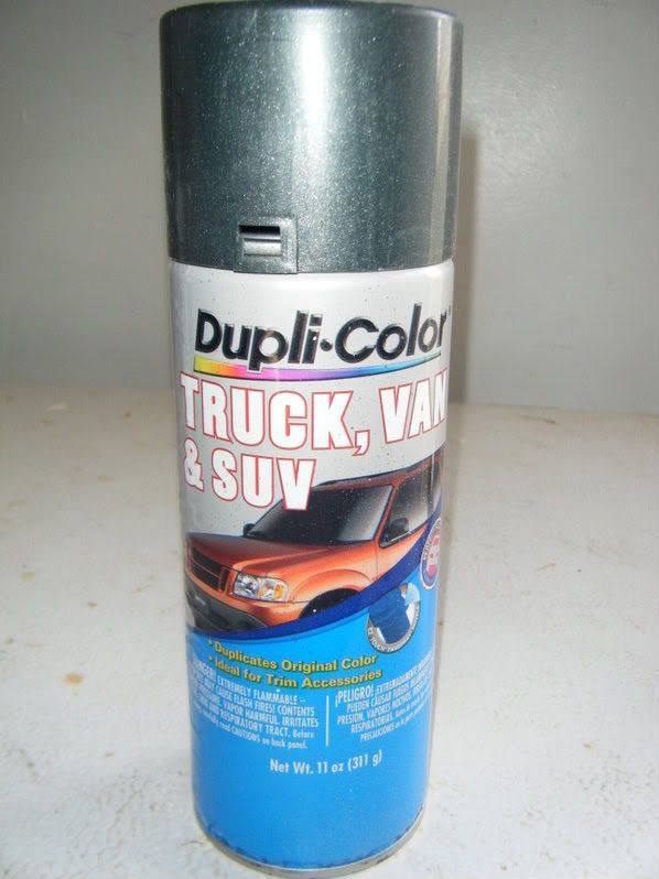

1 Can of spray paint, your choice of color, I choose gunmetal (car spray paint)

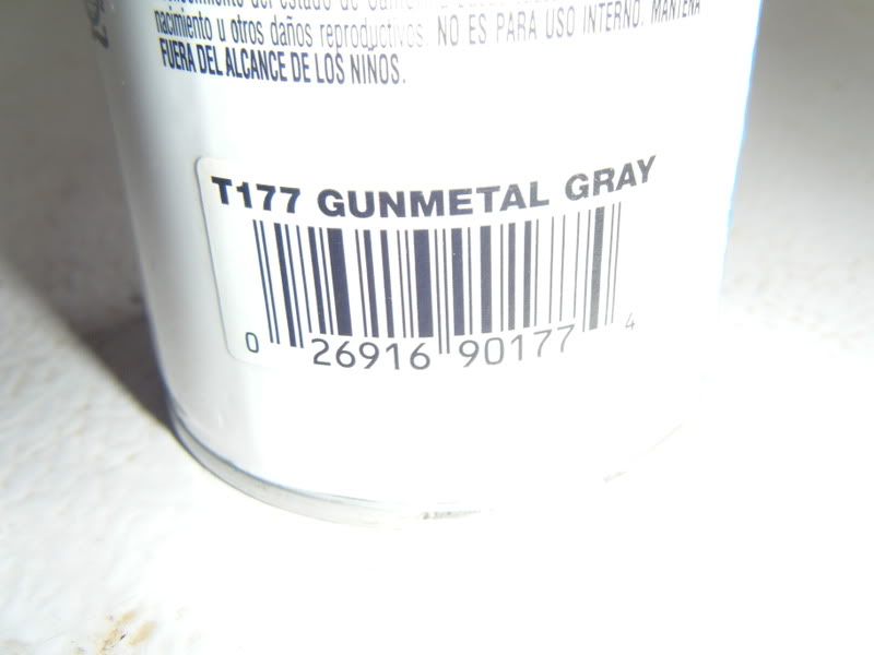

what brand of gunmetal is that?
