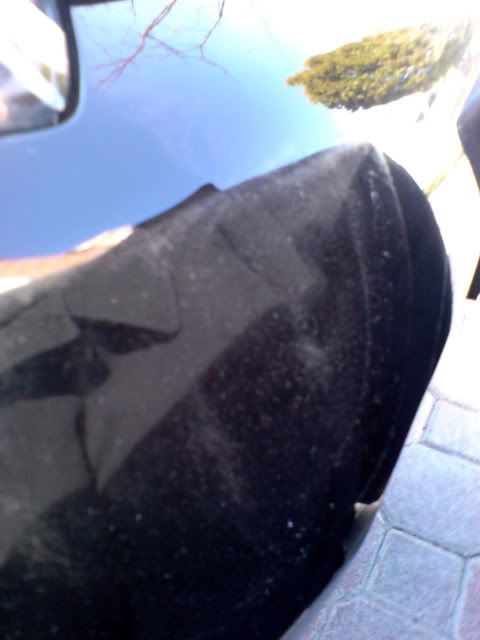

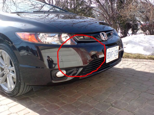

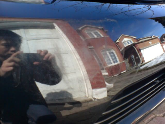

Alright, all of us know during winter our cars are all covered in salt and dirt that we don't see any damages to our car. Well, yesterday I washed my car and today I found this BIG ASS nasty swirl/scratch thing. I don't even know if I got hit while my car was parked or... what I dunno.... sucks!!!!
Will those scratch removal thingees work on this massive swirl? (Sorry for the bad photos but... yeah...)

Use a mildly aggressive paint cleaner/swirl remover (start with a Meguiars M80, then a M83 if M80 doesn't work) with a DA buffer, and it should take care of the marks (assuming they are not deep enough that you can actually feel them with your fingers).

If you can feel them with your fingers, then the scratches/marks are unfortunately too deep to be removed by any buffering methods available. :( Buffering might be able to help you hide some of the imperfections, but not remove them in this case.

wait till the summer and get it primed and painted or live it with :p I found one on mines after driving my car during the second winter i had it, it really does suck.

looks like someone backed onto you or you bumped into another car or object.
it doesnt look too bad but wont come out with simply with a paint cleaner. you need a buff and polishing compound to fix that to the very least.

Ya I think at lease that to fix a bit of it... Sigh.... now no matter how clean and waxed it is it'll always have that CRAP on... haha suckkkkkkkkksssss!!!!!
