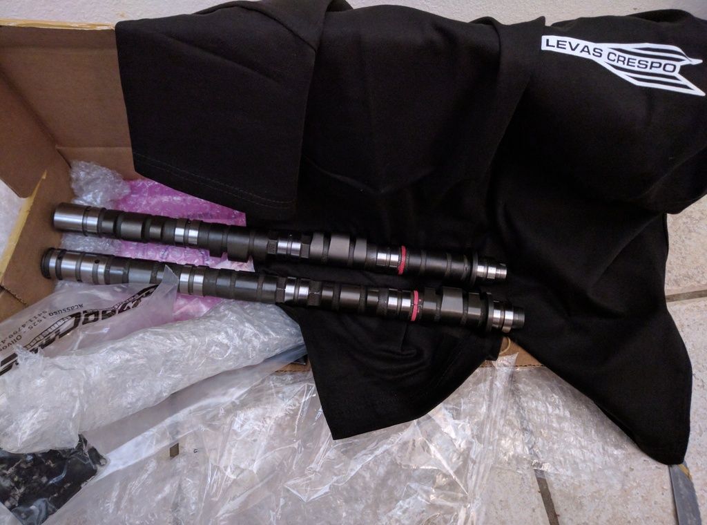

Well guys i just wanted to give my feedback on stage 5 Crespo camshafts that are going in my motor as we speak. Running supertech 95 psi springs and gonna get tuned by Steve at etunez. As the installation goes on I will post more pictures of the installation and hopefully even a dyno with video when done.

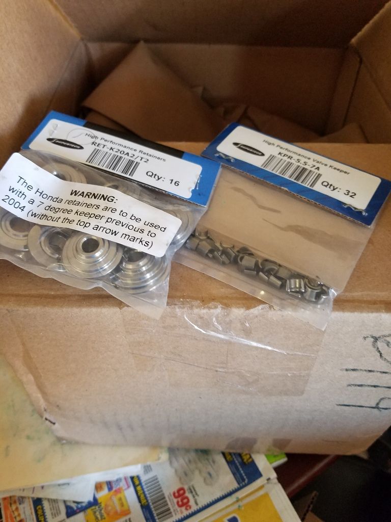

Supertech 95 psi dual springs
Skunk2 seats, supertech ti retainers and cotters

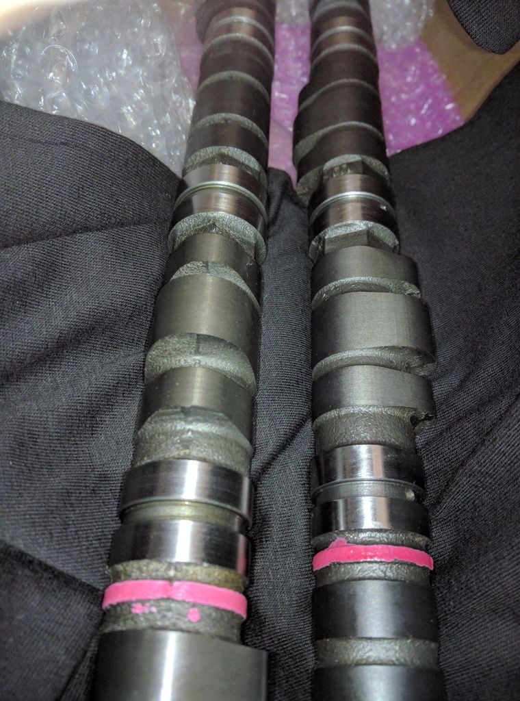

Here's a pic of the cams as they came in today
Supertech ti retainers and cotters

fail
cams were so horrible designed they popped my tensioner from all the chain slap i even tuned it to a 0* cam angles and still broke it. I heard a big air leak comming from my motor. Then i removed my tensioner and noticed air bubbles coming out on the side of the piston.
