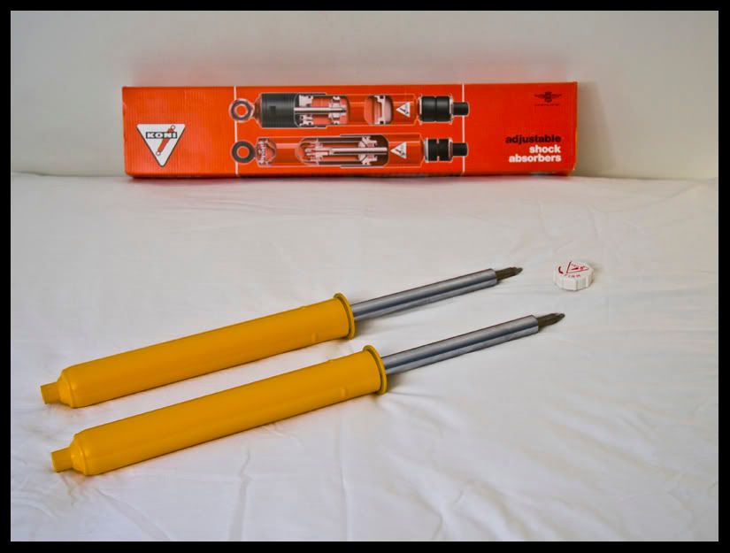

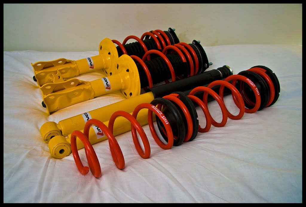

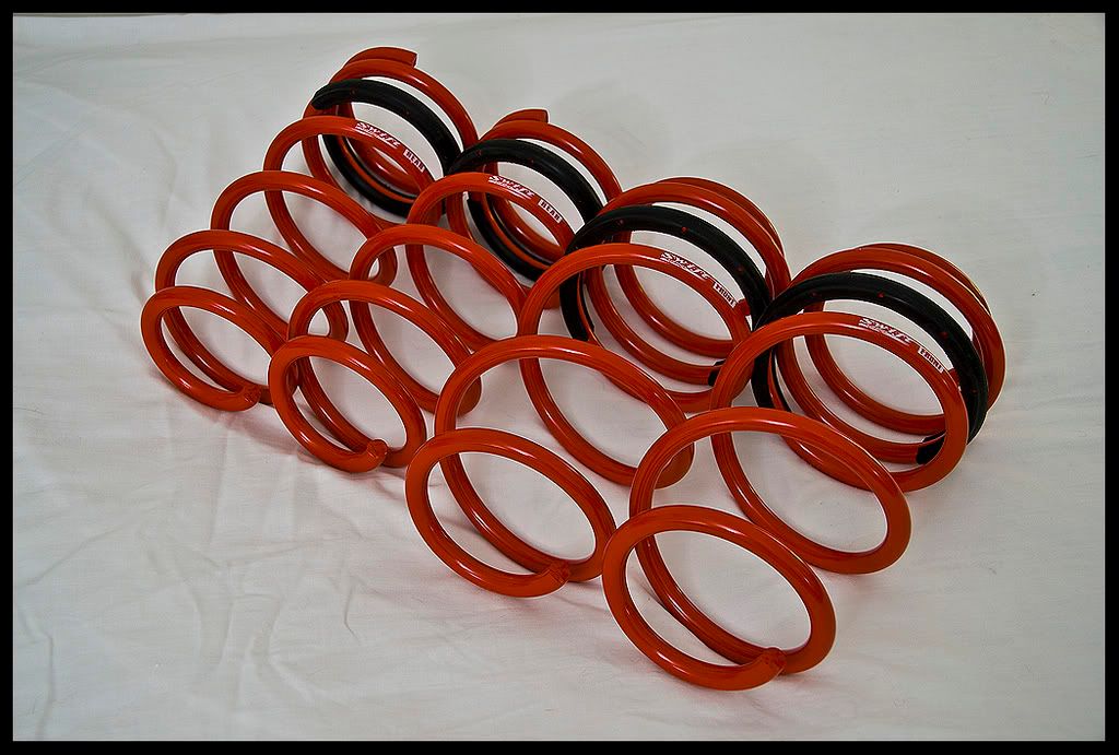

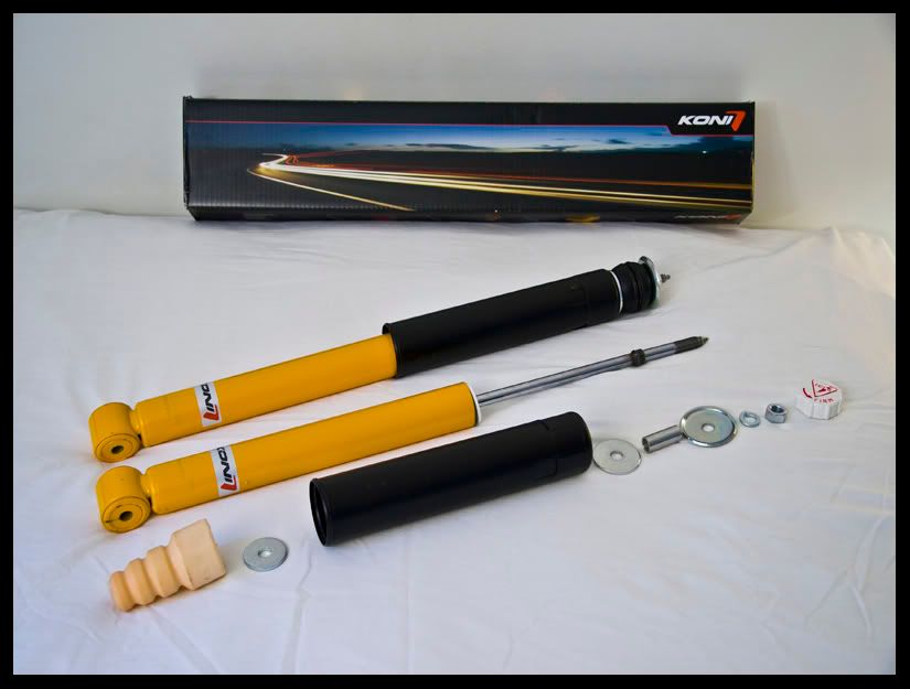

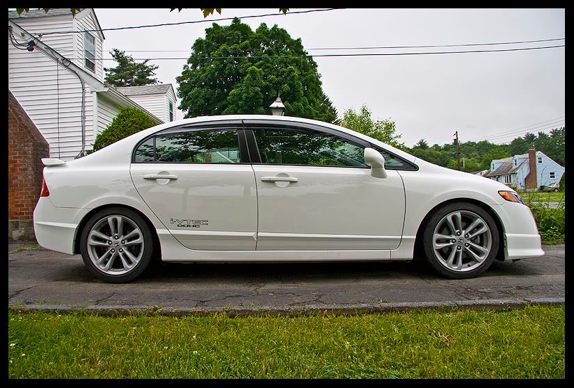

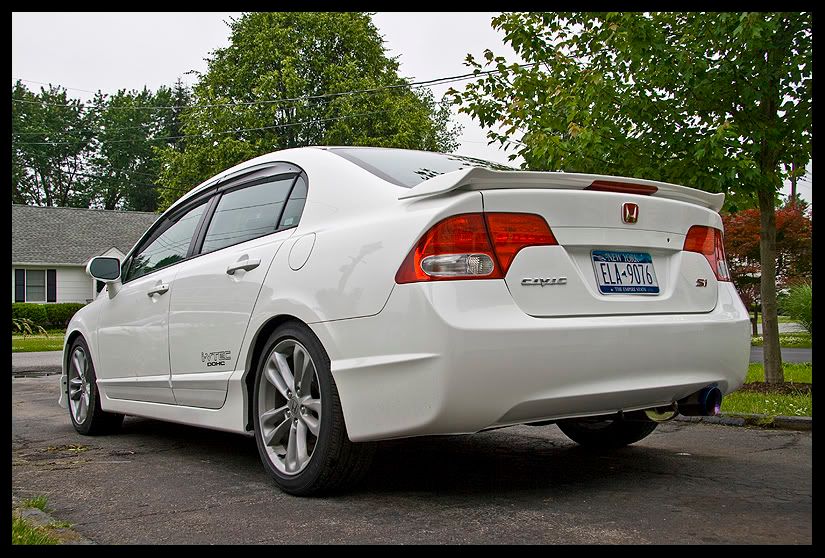

KONI/ Swift Springs Pictures:
Photos taken with <50 miles on suspension.
Photo taken with ~500 miles on suspension.

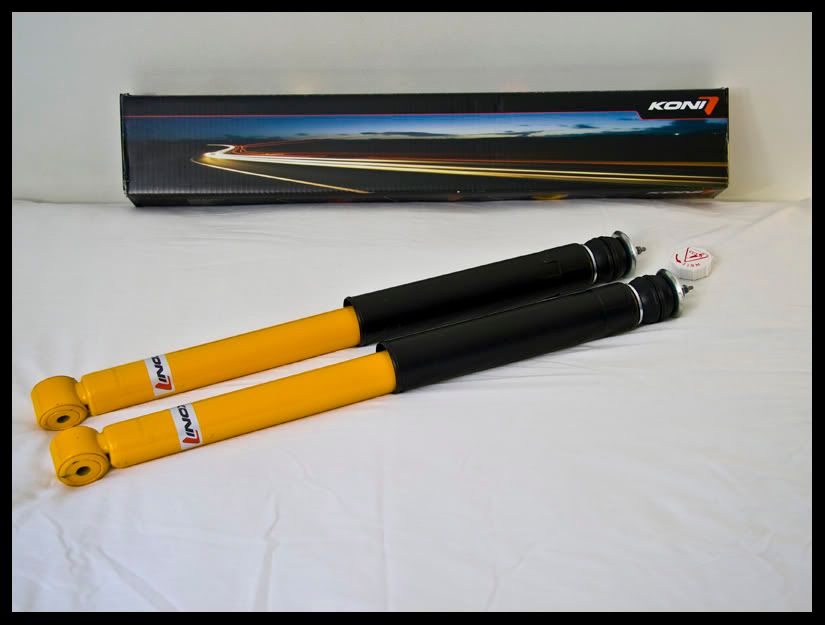

General Suspension pictures before install:

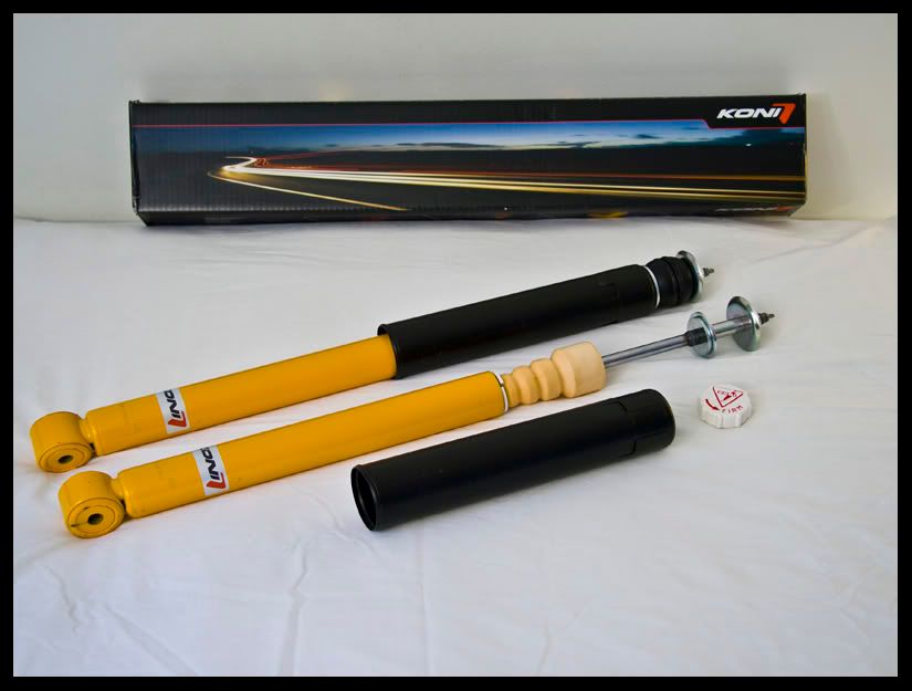

Typical KONI front inserts:
Typical KONI rear shock assembly, note stock dust cover and rear bump stop. Neither front or rear were cut for install.
Typical KONI rear shock assembly, without dustcover to show typical build.
Typical KONI rear shock assemblies, note that the body of the vehicle goes between the two rubber bushings.
Typical KONI front insert and KONI rear shocks.
Typical Swift Sport Springs, note the less coil design when compared to similiar drop; Eibach Prokit.
Typical KONI front insert mounted within stock front housing to complete the full assembly of the macpherson assembly.

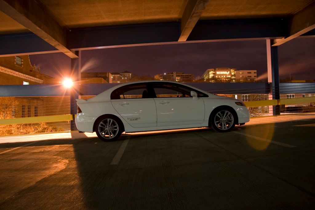

HFP Pictures:
HFP Suspension w/ 18" rims
HFP Suspension w/ 17" rims 225/45 tires
HFP Suspension stock rims
