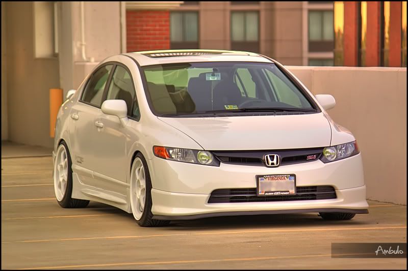

I have my camber set more for "fashion" rather than "function". There's a small road course not too far from where I live and I would really like to try it out without changing my camber(Ingalls camber plates are a PITA to adjust). How will my settings affect the car? It's 1.1miles for the short track, and 2.0 miles for the long track. The short track speed averages around 65mph, so I don't think it's too fast.
Edit: I will be running on the stock Si wheels with Dunlop Z1 Star Specs.
Front: -1.5 degrees
Rear: -3.0 degrees

That's a super nice looking car.
Unfortunately I don't road race, so I can't comment. What rims are those by the way?

With -3 in the rear you'll most likely experience huge understeer. From looking at your drop and rim clearance to the fender you might also rub quite a bit from hard cornering at a road coarse.
