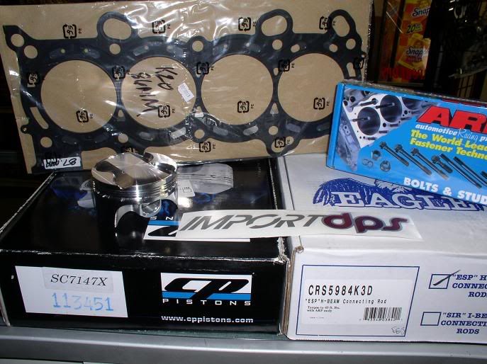

Got all the parts together for the block. Going to have Wayne of RSTech get me all the new oem parts from the Honda Dealer he works at. Want to keep it fresh. Afterall, were taking apart a car that has 17,000 miles.
Some pictures of the block parts. Just a standard 87MM Golden Eagle Honda Head Gasket, CP 12.5:1 Pistons, Eagle K24 Rods and ARP Head Studs.
