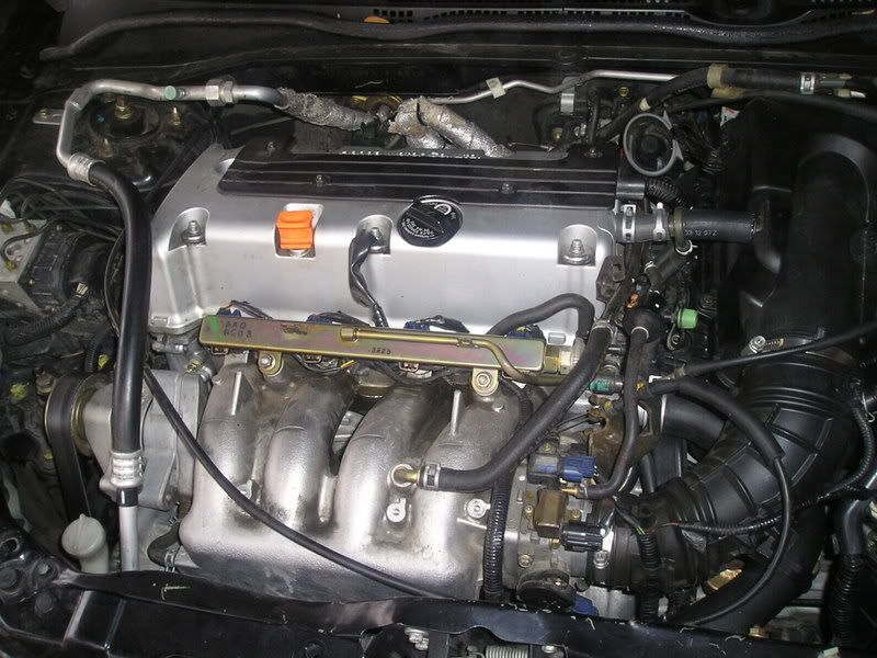

http://i273.photobucket.com/albums/jj221/maury1965/P1010005.jpg
thats a k20 head, it doesn't have the water outlet built into the intake manifold like the k24's do...
Good find.
Good find.
So k20 head with a k24 block and who knows what internals?
