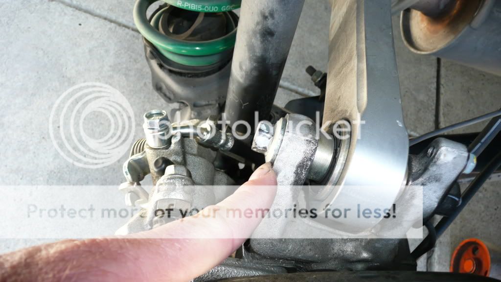

3.)Diconnect the ABS sensor and snap it out of its bracket as well. You will be able to use your sensor. No modding necessary. Also diconnect the brake line from the inner fender and the main brake line. (same place)
(this is my abs sensor on the disc brakes I am running. I used it from the drum set up so I didnt mod it!)
