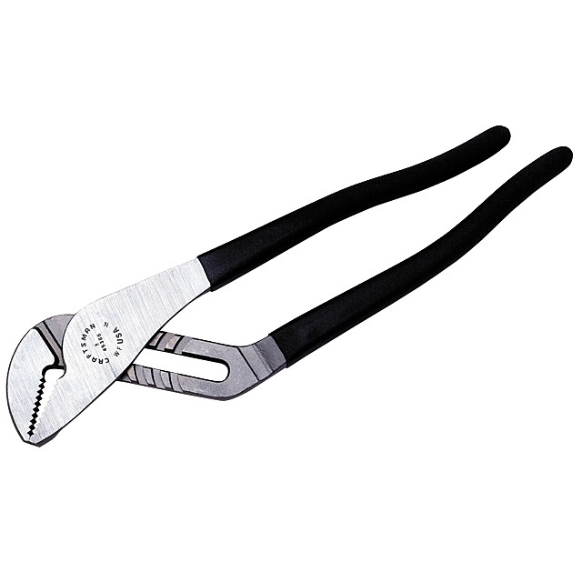

Posts: 586
Originally Posted by DRIVEN1 View Post
Moose,
What do you use to compress the caliper? Do you have a brake caliper piston compressor that you use? I never used one on my Audi, but looking at the DIY for front brakes the guy mentions:
Special Tools Required
Brake caliper piston compressor 07AAE-SEPA101
I googled this and nothing came up, just want to make sure that I have all the tools that I need before I start the job. Thanks Mike
This is the proper tool to push the piston back into the caliper
Craftsman Disc Brake Pad Spreader - Model 47365 at Sears.com
But I normally just use a set of slip joints ... and squeeze it back in
Keep and eye on the M/S resevoir ... it has a tendancy of overflowing when you push the pistons back .... I like to leave a rag under it to catch any overflow.
MAke sure you have a can of brake cleaner to clean the calipers / rotors / and M/S when you are finished ... Keep in mind that Brake fluid EATS paint ...clean up any spills and becarefull touching anything if you have handled a cailper etec with brake fluid on it.
Moose

Never worked on Honda brakes, do you need the spreader to open them up when putting the new pads in? Thanks for reminding me about the brake cleaner, don't have any here so I will pick some up. Thanks Mike

As the brake pads wear they get thinner .... as a result the piston pushes out more ... when you put fresh pads in you need to push the piston back to make space so that you can slip the caliper down over the thicker pads.
You only need to remove the lower caliper bolt (12mm) , and swing the caliper up out of the way. The pads sit in the caliper bracket surounding the rotor
Lube the "ears" of the pads backing plate with anti seize where they slide in to the caliper bracket ... also put a bit of anti seze on the back of the pads backing plates where they touch the caliper ... this minimises squeel and other noises.
While you are at it ... use some high temp brake lube and lube up the sliders
