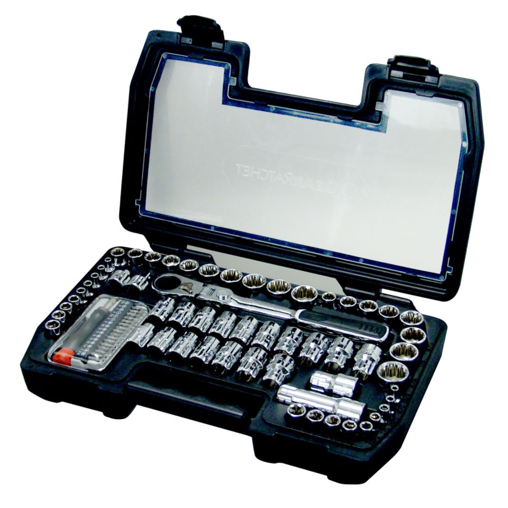

You could also use a Gear Wrench Vortex socket set as it has a pass through center where you can use an alllen key to hold the bolt while turning the nut:
blueroadster is offline   Reply With Quote
Once you buy one of these sets, you will be amazed... I reach for my Gear Wrench sockets more often than my other stuff. The GW has a nice short profile that lets it get into tight spots (think extrememly compact head).
And yes, I bought the GW set just for the strut installs on my Subaru... great tool though!
