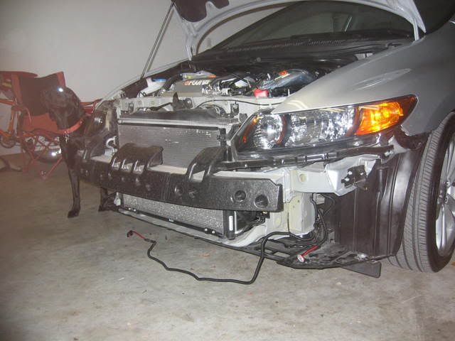

now you will need to remove your front bumper, i dont think i need to show every step of that because so many people have already posted it.
once the bumper is off, there are three 10mm bolts that hold the headlight and bracket to the car. remove those and take the headlight out... warning this project can not be done without taking the bumper off, so dont try any shortcuts., also use this picture for making sure that you hook the right connectors to the right headlight, when you re install.

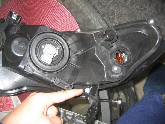

now use the star bit, not sure of the size, i have a set and just tried it until i found the right one., remove the four star bit screws on the back of the headlight. now remove the bulbs (headlight, hi beam, blinker,)

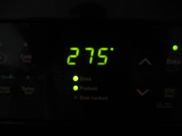

now preheat your oven to 275 degrees,

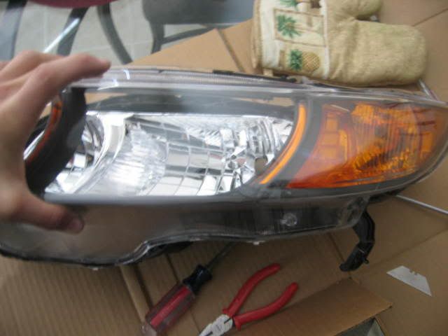

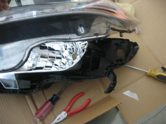

cook the headlight at 275 degrees for six minutes and make sure that you dont leave it to long. once you take it out of the oven, use the flathead screwdriver to start prying the headlight assembly away from the clear lens cover.

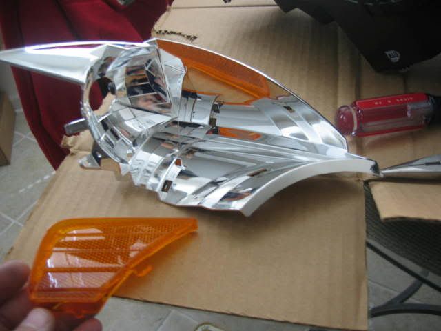

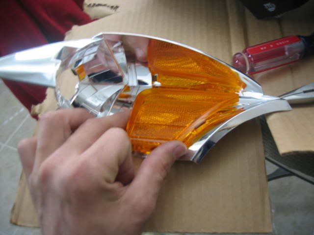

once the lens is off there are two screws that hold the light assembly to the back cover. remove those and the chrome assembly with the amber plastic peices should slide right out.

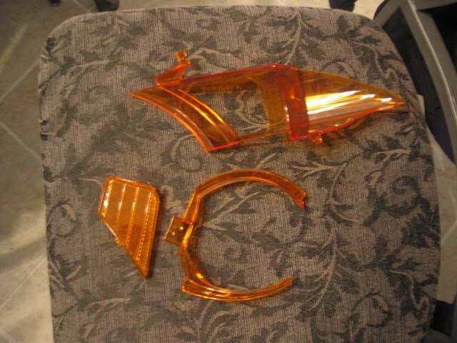

when you get to this point look at how the amber peices are held on the the chrome assembly. it is very easy to just pop those peices off
