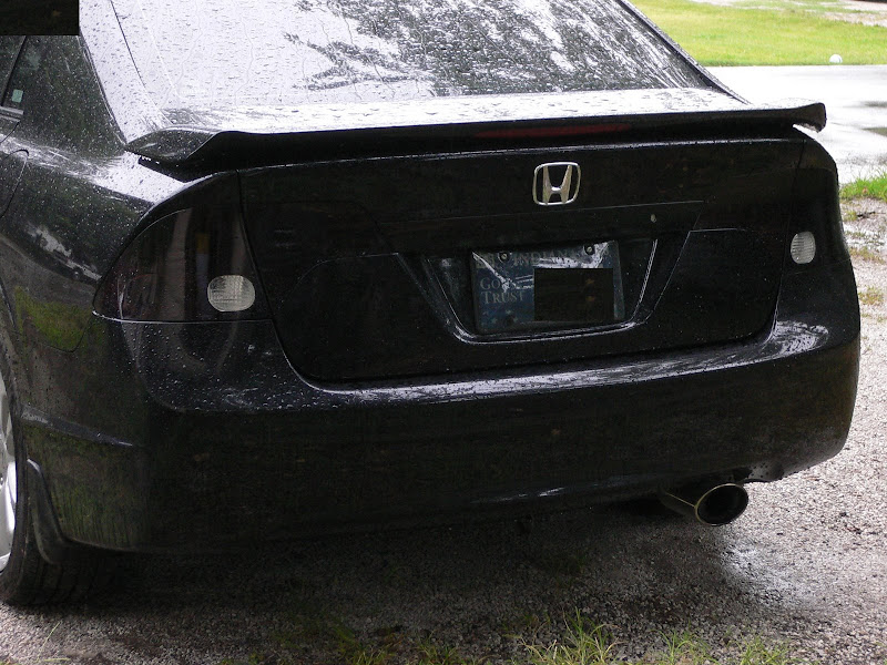

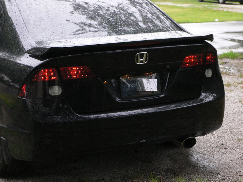

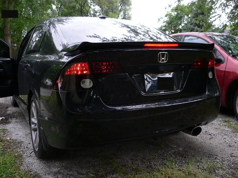

Best thing as far as smoking goes that I have found is VHT nightshades, but the biggest thing is using a proper clear coat (aka using a gun) you'll almost always have orange peal using rattle cans.
If you use a rattle can clear it'll always yellow over time but for cost savings if you use them make sure you wet sand.
vht nightshades - Google Product Search
this is my Si
with running lights on during the day and then with brakes on
'07 Honda Civic Si

No, I did them. It took me about 4 hours with the disassembly and paint. Then a day to dry, a couple hours of wet sanding, then a light buff.
