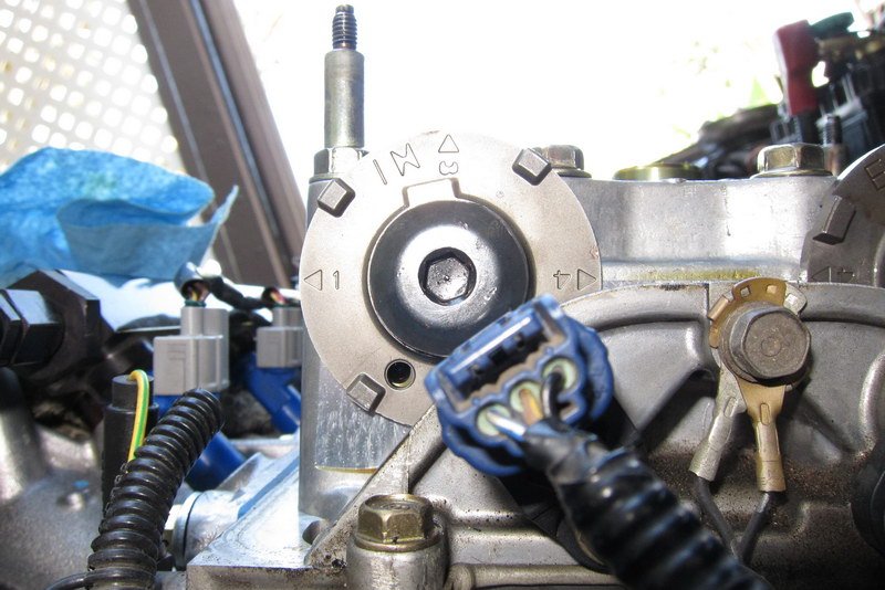

The problem with the Kelfors 179-A
slight off centered cam trigger alignment hole
here is a pic of the OEM cam with a centered cam trigger
fid3L is offline   Reply With Quote
Good pic Fidel!!!
